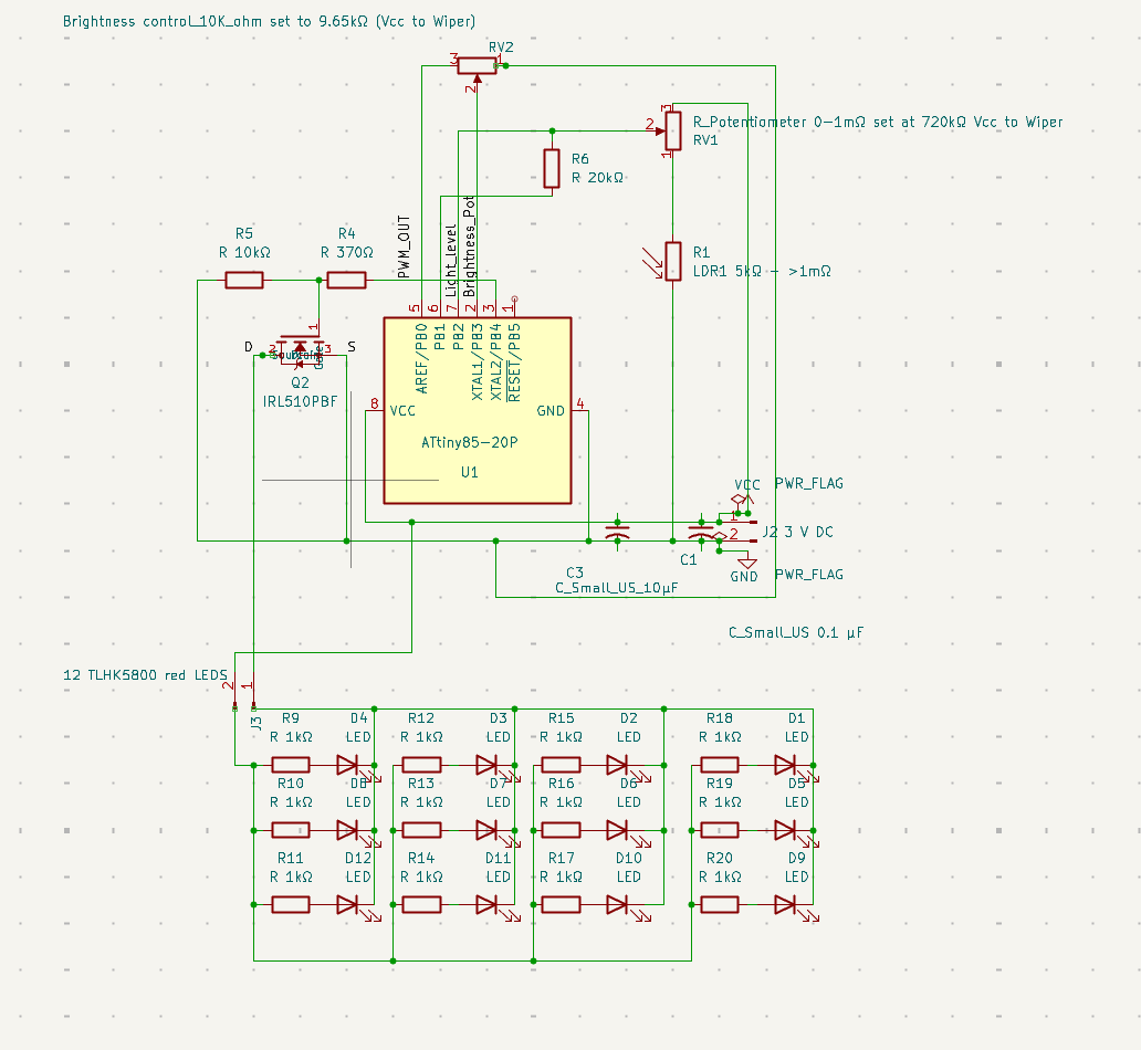

I have a sketch for an ATtiny85 that compiles but does not perform as expected and I am at a loss for why. I am posting both schematic and sketch here. My circuit is battery powered and uses a ATtiny85 to light an LED array in dark conditions controlled by an LDR. LED brightness is controlled by PWM that is adjustable by a pot. PWM is increased as battery voltage decreases. To save power the sketch uses ATtiny85 sleep modes and drives the brightness pot. Problem the circuit only lights the LED array if booted in dark conditions, and then will turn off the LEDs in ambient light. However if booted in ambient light it will not turn on LEDs after transitioning to dark. I know that the sketch detects the dark condition because quiescent current changes from 65 microA to 35 microA when shifting from light to dark conditions. I cannot find the logical error that prevents lighting the LEDs when transitioning from light to dark. I have ruled out reaching LDR threshold values by measuring voltage in light and dark. I am a newbie and have used a variety of LLMs to help with the code and to sort this out but they are not up to the task. Any help is greatly appreciated`Use code tags to format code for the forum
