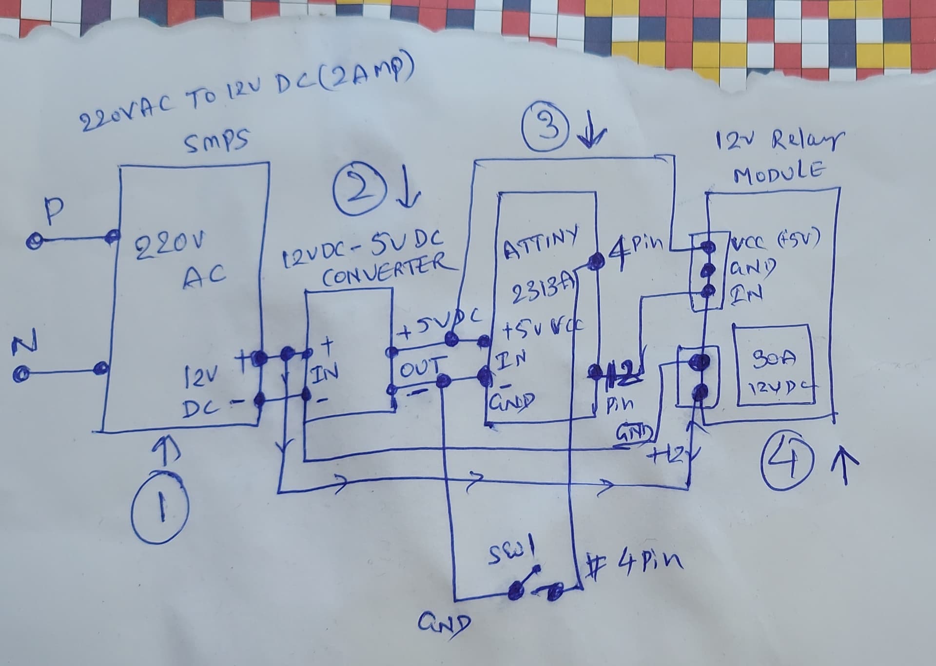

However this is the complete connection diagram of my project
If I press SW1 (as per the diagram in the post number 25) then the relay should ON. Now the code is working however whenever I connect the microcontroller GND pin with pin#4 then immediately the microcontroller is heating up.

Hi, @chandu-mca06

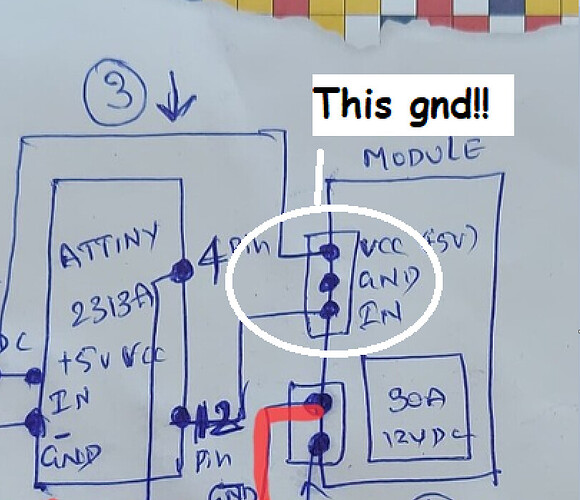

Please review your circuit diagram in post #25, and fix the gnd error to the relay module.
Then repost the correct schematic in a new post.

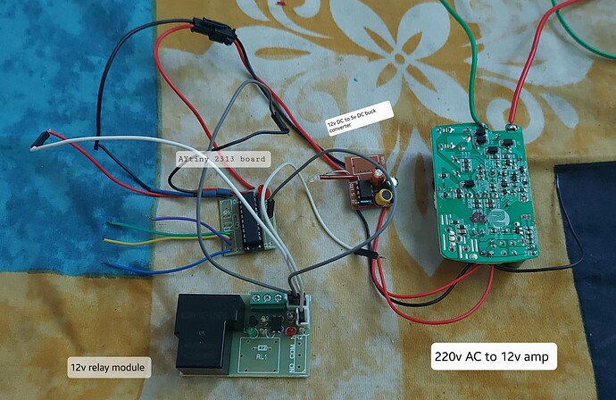

Can you please post some pictures of your project?
So we can see your component layout.

Yes I have DMM, what do you mean by the GnD error to the relay module? GND is common for both 12v and 5v power modules.
Do you have a gnd connection between gnd on the relay and gnd on the 2313?
Not shown in post #25.

I followed the following connection diagram
This is my actual board connections.
I am ! Mind you, that small break-out board may be doing that for you.
The GND on the 12v side of the DC-DC converter may not be the GND on the 5v side of it.

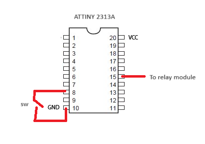

I connected the correct pins to VCC and GND of 2313. Sorry I am using physical pins of 8 and 15.
This was not clear from your schematic.
So that is GPIO 6 & GPIO 12 (not 2 & 12 as is in the sketch) You have still not told us which core you are using (i am going from the pint of view of it being the ATtiny core)
This is the board manager I am using
I marked the PINS which I am using for this project as below
BTW I am not facing any issues while uploading sketch. I uploaded successfully but if I connect Pins GPIO 6 and GND pins the relay is ON but at the same time the micro controller is heating up. This is the actual issue.
