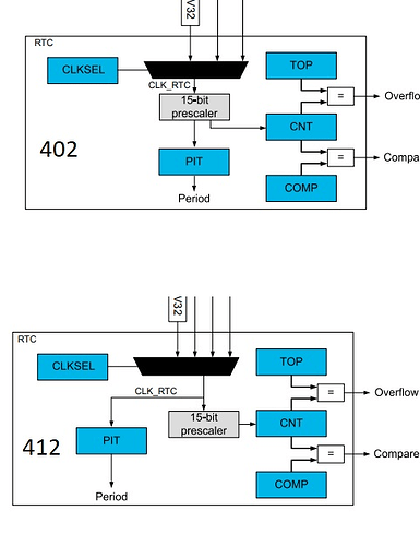

In terms of dialing out different times for tasks, why doesn't the RTC prescaler work in the below code?
LED continues to toggle once per second regardless of what's loaded in the RTC prescaler bits.

From the data sheet, it is not clear to me that the prescaler output is used by the PIT. Check the Microchip forum.
Hmm- Yes the 412 datasheet shows RTC is not prescaled for PIT, but the 202/402 shows it is. I'm actually programming the 202 and that prescaler doesn't work there but the graphic suggests it should. More digging...
