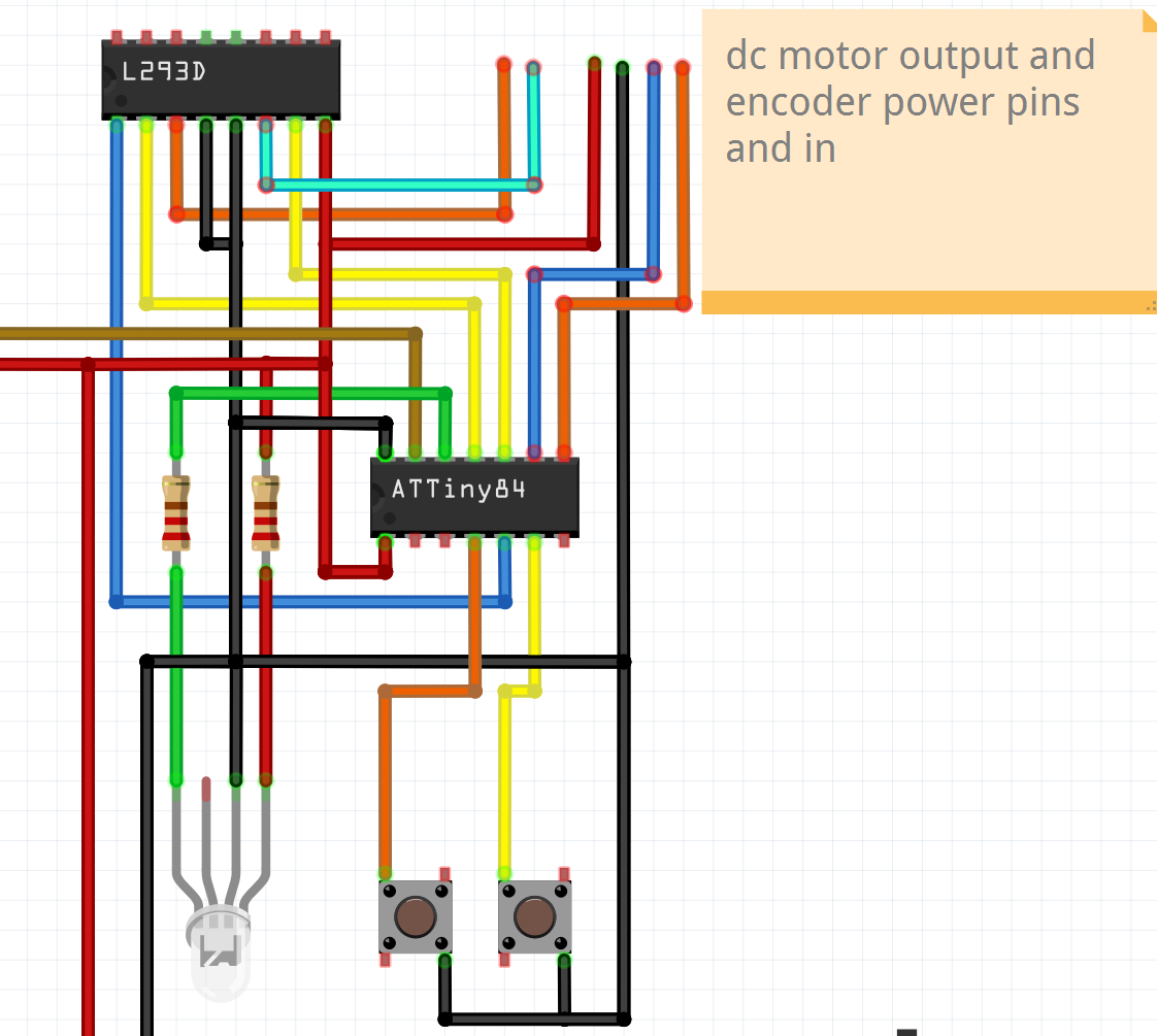

Here the circuit :
How will you instruct the motor to return to the zero position? The motor has no intelligence. The encoder doesn't even know what the zero position is.
To get your program to give such control, it must remember how many steps the encoder has done since the zero position, and then to return to that position you need code to move the motor to that encoder position. Have you programmed to do all that?

Apperently this :
PCMSK1 |= (1 << PCINT4);   // Activer l'interruption sur PCINT12
  GIMSK |= (1 << PCIE1);       // Activer les interruptions du port A
  // Autorisation des interruptions globales
  sei();
but it doesn't seems to work....
But does it follow the data sheet narrative and documentation on interrupts?
From where did you get this vector name?
The ATTINY84 has two ports so the name should contain an indication of the port.
If the correct vector is not defined to match the interrupt then the program will crash and restart as soon as an interrupt is triggered. Flash a led in setup() to see a crash or add a delay().
Ensure these all match the chosen port/pin:
Which Arduino core are you using for the ATTINY84 ?
