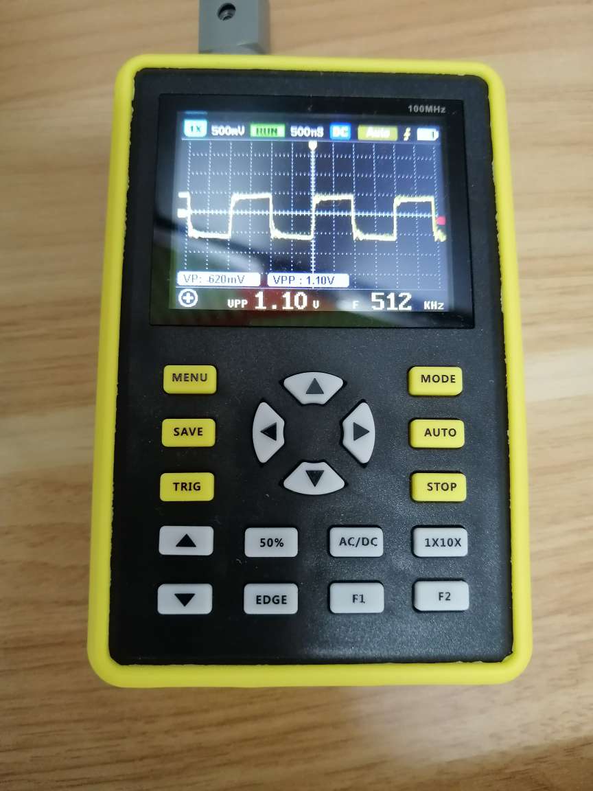

How do you know it is 1.24V PTP? How are you measuring that? Multimeter? Oscilloscope? What model of 'scope? Perhaps it is 5V PTP but your equipment is unable to measure it accurately?
Hello @PaulRB ,
Very good point. The first thing I did after reading your reply was to measure the average DC Voltage at PB4 (with PB4 set as output) using a DMM (model Uni-T UT33A+), and indeed, it says 2.5V (the square wave has 50% duty cycle). So according to this, Peak to Peak must be 5V.
Then I again looked at my Oscope (yeapook handheld Oscilloscope 5012h .. literally got it from here).
This is what it shows.
Now I don't know what to believe.
best regards,
aquaman

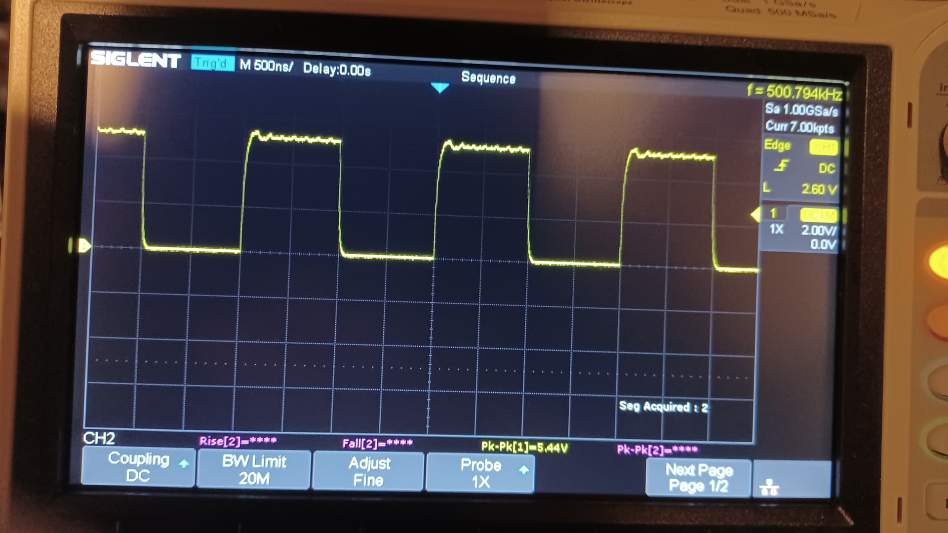

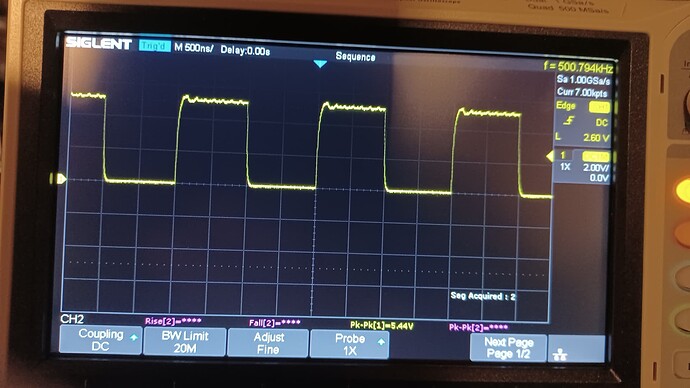

Well I spent some time going over the data sheet and the code and it seems it should work. So.. I got out an Attiny85, my programmer (a bit of a problem since I haven't done this in a while) and a scope. Here is the result...
It works fine in my basement, ~500KHz and 5.44 p-p. It appears you have measurement problems or a bad device.

Regarding @Paul_KD7HB 's suggestion, I appreciate the reply. Perhaps the photo in post #5 is bit blurry, but near top middle, its showing DC (in little blue square background). So, the scope was in DC mode.
