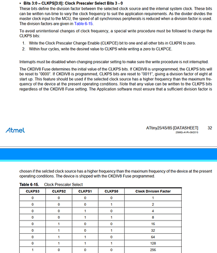

1. When LF (Low Fuse bots) = 0x62 (0110 0010), CKDIV is programmed and 8 MHz Internal clock frequency. As a resuly, the operating frequency is 8 MHz/8 = 1 MHz. Why are you saying about 4 MHz?

  1. At MCU startup the CKDIV being programmed causes the clock prescaler initial value to be set at a division factor 8. Nothing prevents your code from clearing CLKPS1 after startup to change that into a division factor 2 to get 4MHz (or change it into whatever prescaler value with subsequent internal system clock frequency you want).
Explained in the datasheet.
