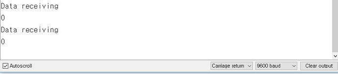

In the start I want to send some byte of data through I2C comm and tried to scope the pin with oscilloscope but its not giving me the appropriate results. Looking on the internet about different ways to make attiny85 work with I2c is really heartless and I could not achieve teh task. Finally, I tried to make attiny85 as master and arduino Uno as slave as it was spare in my box.
I tried to make attiny85 as master and send data to arduino and looks the output on serial monitor but its showing zero.
For the reference, the master and slave codes are attached and my task is just simple to check on serial.

Arduino Uno smd as Slave
const byte add = 0x08;
int byte1;
  Wire.begin(add);                // join i2c bus with address #10
  Wire.onReceive(receiveEvent); // register event
  Serial.begin(9600);           // start serial for output
  Serial.println ("Data receiving");
  Serial.println(byte1);
void receiveEvent(int bytes)
  byte1 = Wire.read(); // receive byte as a character
and the serial output I am getting is attached also below.
Kindly give your valuable suggestion what am i doing wring here..

Regardless of any other issues, the code you have posted still has several calls to TinyWire so that won't work.
What a small bug can do to the code. I was changing the library again and again to test and that's where I left my mistake. Thanks for pointing it out and now its all sort out
