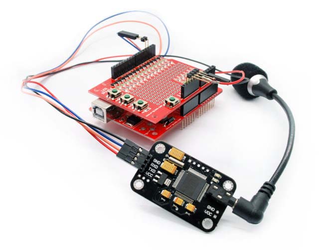

The RFID has working now by having some tweak on the code and I also succesfully integrated it with the text-to-speech module. The device now outputs audio instruction everytime I scan a tag. My problem now is that the sample code (provided by the seller of my speech recognition module) is not working, I don't know where I went wrong...
Here is the code:
/* Demonstration Sketch for e-Gizmo Voice Recognition Module *
*  by e-Gizmo Mechatronix Central
// connection guide
This Demo requires a LED Shield
VR TX -> gizDuino RX
VR RX -> gizDuino TX
VR GND -> gizDuino GND
VR VCC -> gizDuino +5V
Record Switch is S2 (A3)
This code is written for gizDuino+ Controller
To use with gizDuino, remove all "1" in the Serial1 object
e.g. Serial1.available to Serial.available

I am using Arduino Mega 2560, thus the serial1 is appropriate right? I noticed that the code didn't declare any pins to connect with, I assumed that the rx and tx of the SR must be connected to the pin 18 (tx 1) and pin 19 (rx 1), respectively. However, the serial monitor doesn't output anything and the sr doesn't corresponds to the input i make in the serial monitor. I also pressed the record switch (S2) of the LED shield but nothing happens.
Here is a photo of the SR and the LED shield (Pls disregard the arduino that has been used in the photo)
