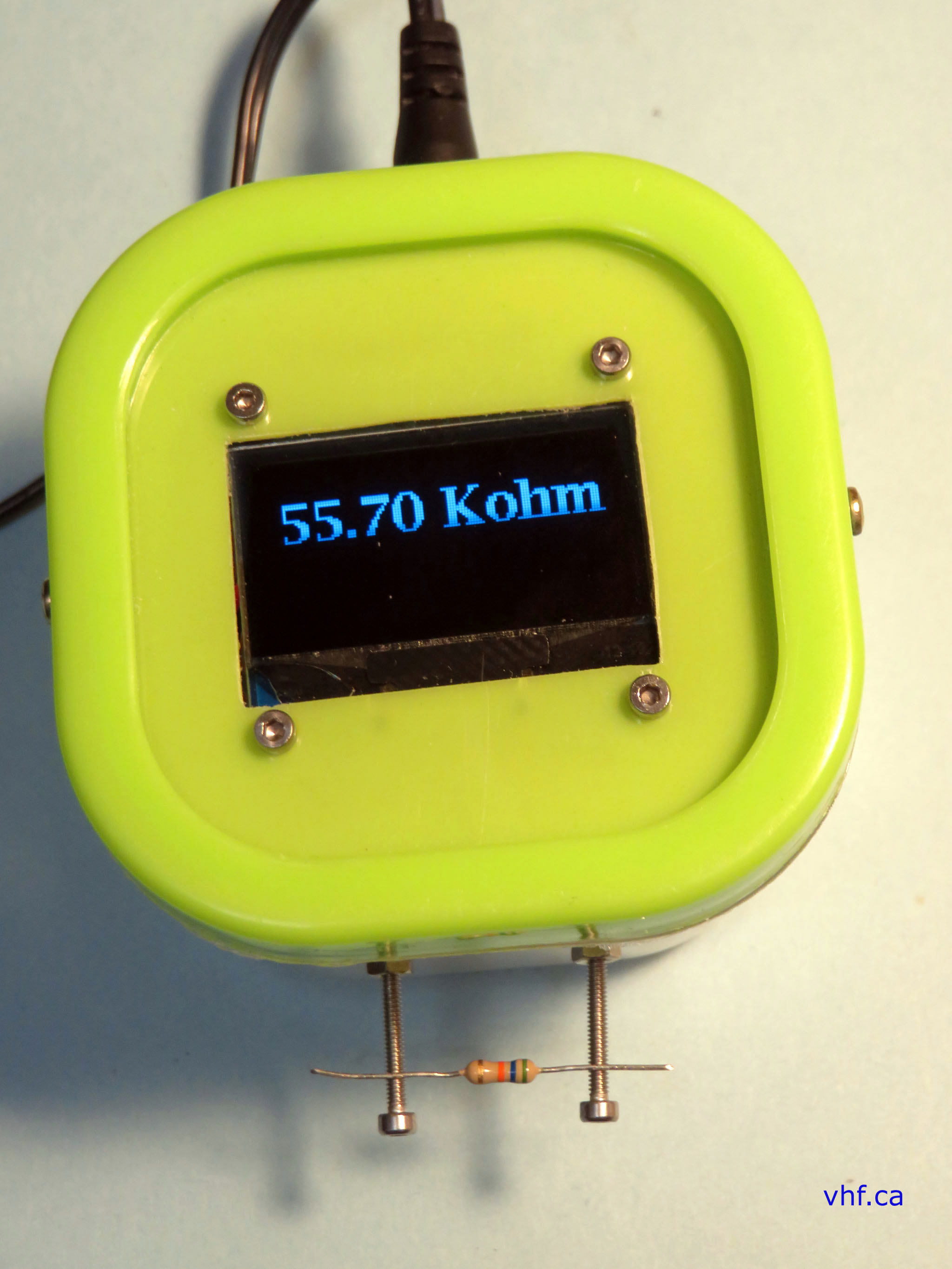

I recently built an auto-ranging ohmmeter from simple-circuit.com, which I modified to work with an Oled display. It works accurately enough to sort resistors from 10 ohms to 1Meg ohms, but for some reason does not measure 150K ohms?? 100k and 220k read fine. I double checked all the calibration resistor values and wiring and found no faults. I was wondering if there was something in the code which is causing this problem. Can someone check the attached code for me?

Anyway, the meter reads the same without it, excepting the 150k ohm issue. If two 150k resistors are put in parallel, it reads bang on 75k, but stays in Infinity mode with either one individually??
I'm just a beginner programmer, but also wondered why they only compute the float value in the < 900 if statement in line 74. Looks like all the high readings from "A1" were filtered out.
Can you mesure resistors in the range of 120-190k (you can compose from two or three in series or parallel if you have no such).
If you get the same result as for 150k I can say you what is the reson.

I removed +1 and changed 1023 to 1024, but still does not read between 120k & 190 as Boffin mentioned. :sunglasses:
The whole problem is in the algorithm for automatic switching between the third and fourth ranges (channels).
Third range: R1 = 100kΩ, fourth range: R1 = 2MΩ.
If the measured resistance R2 = 150kOhm, then
the Arduino DAC outputs 614 on the third range, 71 on the fourth.
The switching algorithm is as follows
  if(volt_image >= 550 && ch_number < 4) {
    ch_number++;
    ch_select(ch_number);
    delay(50);
    return;
  if(volt_image <= 90 && ch_number > 0) {
    ch_number--;
    delay(50);
    return;
The program loops and constantly switches from the 3rd range to the 4th and vice versa.
There will be the same from about 117k to 190k
Auto-range Ohmmeter
The simplest solution is to change the 2MΩ resistor to 1MΩ and the corresponding number in the program. In this case, the maximum measured resistance will decrease from 14.5 MΩ to 7.25 MΩ. I think this is quite enough.
Ok, I added the ul's for to start my good habits. Thanks, it did not make a difference as you said.
Where should I put the analog read function? In multiple places?
uint16_t volt_image = analogRead(A1);
Ok, I totally understand the problem as you outlined it in such great detail. Great!
I'm glad I used sockets for the cal resistors. Changed the 2M for 1M and the constant table from 2000000ul to 1000000ul and PROBLEM SOLVED!
Many Thanks BOFFIN!!
Now I can order the 1% Cal resistors!
I'm glad that I was able to help you solve the problem, although it took a little thought for this. :slight_smile:
Please tell us later what results you achieved after calibration.
Don't forget to click Solved. :slight_smile:
Yes, I did click Solution button, and added SOLVED to title.
It may be months before I get the 1% resistors, but will certainly post again after their installed.
Many thanks. :sunglasses:

If you are concerned about accuracy, take a look at transistors Q1-Q5. These are bipolar transistors, their collector-emitter saturation voltage can be significant (0.4-0.5V), especially in the low-resistance range.
If this will be a problem, you can try replacing them with a p-MOSFET with a low gate threshold voltage.
Yes, good idea. I only have 2N7000 "N" Fets here, so would need to order P-types. For me, the accuracy is good enough, but I may experiment with fets down the road. :sunglasses:
