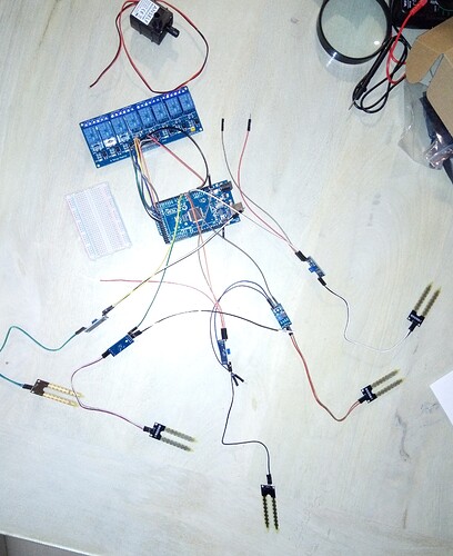

I don't know if my setup is correct
I am waiting for mini water pumps to arrive
Please review the image
OP image.
The photo is a bit hard to follow. A schematic diagram would be clearer. Make a schematic on paper and scan or post a photo of the drawing. How to post an image.
What have you got working so far? You should be able to simulate most of the inputs just using simple things like a pot for analog input, wires, test leads and similar for digital input, and a multimeter to test digital outputs.
I have managed somehow...can you please help me with what I am missing and what are connections
Which soil sensors are you using? What are the modules between the soil sensors and the Mega? What are the 5 white thing on the right?
How are you going to power everything? The Mega cannot power pump motors nor relays.

op image from reply #7. How to post an image.
I meant the modules in the red boxes. Can you supply a link to the place where you bought the soil sensors or a data sheet for for them?
How are you going to power everything? What is the supply voltage for the micro water pumps? You will need an external power supply of the right voltage and enough current capacity to power all of those parts and the Mega. You will need to know the stall current ratings for the micro pumps and the 12V pump to know how much current to plan for.

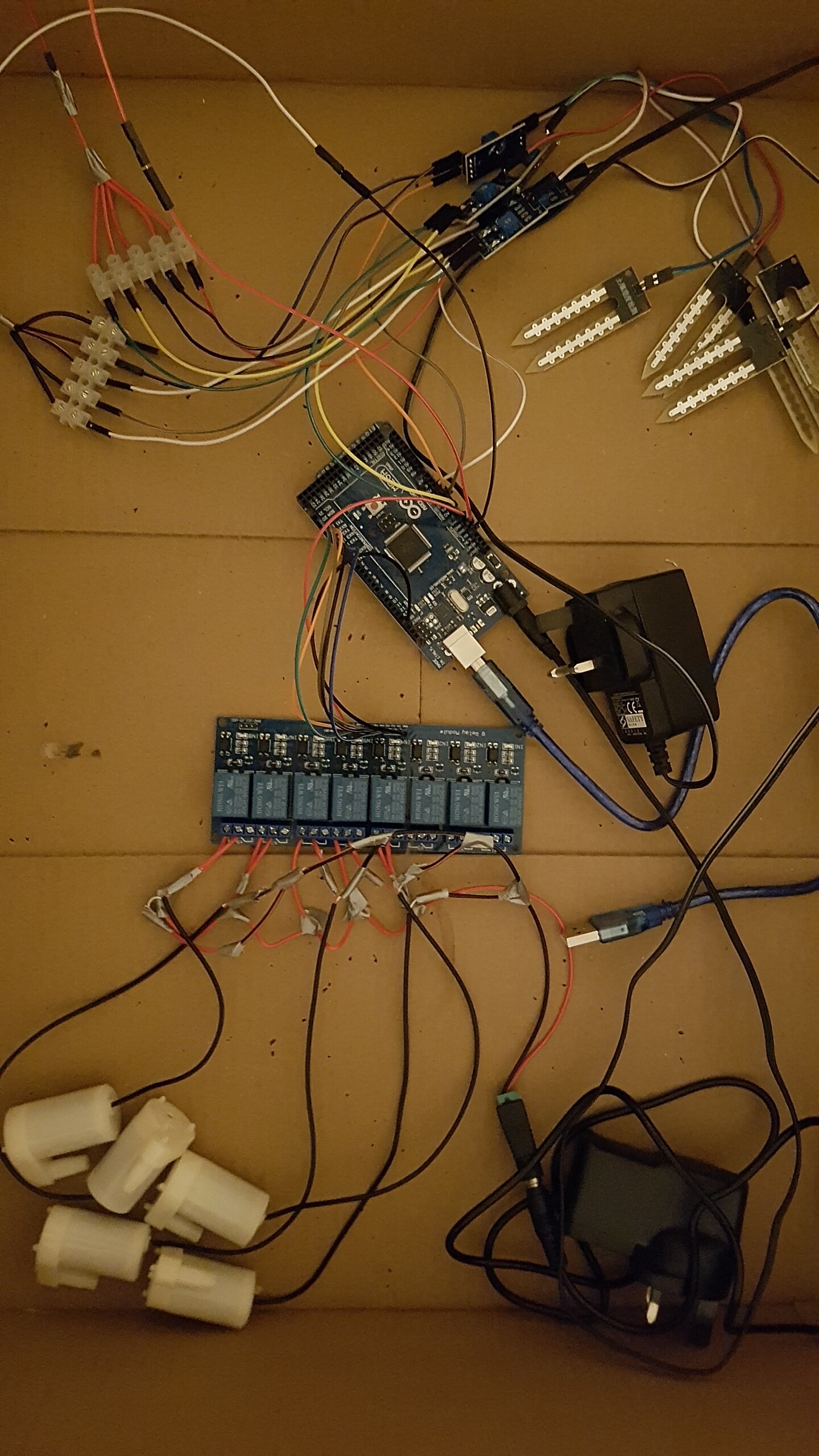

Would like to share the picture of the project with you'll.....I need help with coding ....I am a novice totally with codes
Please shed some light
Appreciate!!
"I need help with coding ....I am a novice totally with codes"
No code so far? Then start with the basics. Using commands from the serial monitor, see if you can operate a relay from the arduino. Modify the "blink" example and see if it will operate the relay. If the soil monitors put out an analog signal, see if the example "ReadAnalogVoltage" will show an output value.
