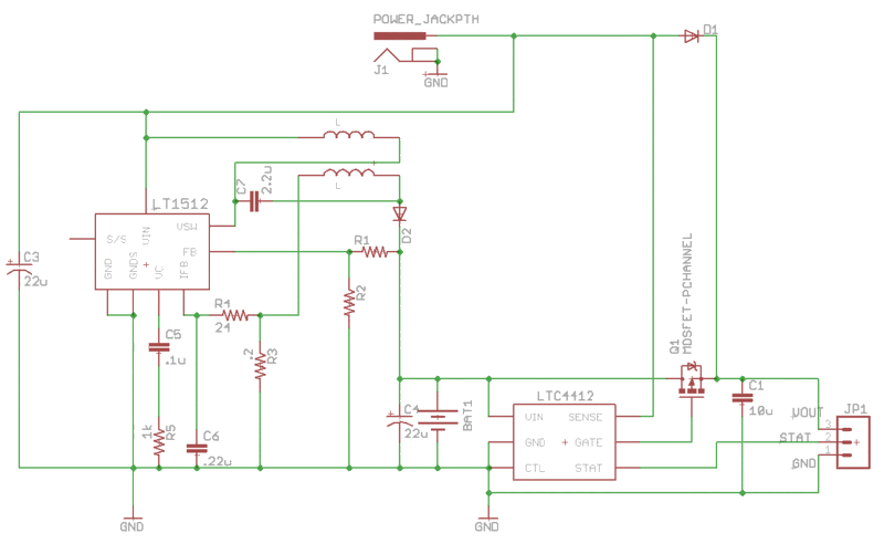

Ok, I picked a chip for each purpose and came up with this:
I used the LT1512 for the charger and the LTC4412 for the powerpath controller.
I'm assuming I'd use it with a 5 or 6 cell NiCd or NiMH battery.
The datasheet for the powerpath controller had SOME info for using it with a battery charger but I'm still not sure I "get" how it operates. It looks to me like there is SOME possibility for the charging circuit to end up powering the output, but I guess that would only happen if the aux source (wall wart) was not present and the charger was charging, which should never happen - because if the wall wart's not there, the charger won't work.
There are some pricey components out there for this sort of thing! The charger IC suggests a particular dual inductor that Mouser wants almost $7 for! I may switch the charger to the Maxim MAX712 because it looks like a cheaper build that way.
Still I'd appreciate comments from some of you who have done this sort of thing before I run off and build it.
I did not check your solution in detail but it looks like it should work.
The reason it is pricey is that you are using a SEPIC converter which can operate in step-up or step-down mode. Li-ion could work better (flat discharge, either always step-up to 5V or step-down to 3.3V). Going with 3 Ni-MH cells (5V system) or 2 (3.3V system) would give you a step-up. The dual inductor is replaced with a low cost choke if the SEPIC requirement goes away.
I am not sure how much current you require but the LT3101 and LT3456 are single chip solutions that should work. They are only available in QFN packages.

I saw those one-IC solutions but I am hand-soldering (for now at least) so QFN packages are out. From Maxim, I saw the charger IC I mentioned above (MAX712/713) but at second look I'm not sure if it's realistic given it's voltage requirements.
As I mentioned above, the idea with this circuit is to power a typical Arduino that's using a 7805, which means that both the battery and wall wart have to be between 7.5 and, say, 12v. To me, that made the SEPIC topology attractive because the wall wart and the (fully charged) battery could be pretty much the same voltage. If I went with the MAX713, I'd need the wall wart to be significantly higher (it wants 1.9v * cell count + 1.5v minimum), which means I'm burning off a lot of waste in the Arduino's voltage regulator when it's operating on wall wart power (which will be 99% of the time).
I suppose I could put a voltage regulator on this circuit and feed the Arduino's 5v pin instead of it's Vin pin, but my particular Arduino has a pH amp circuit that needs a Vin > 5v so that solution is out.
Total current requirement is unknown but there's a lot on my 'duino clone (two 328p's, an MCP23008 for an LCD, an ENC28J60 Ethernet interface, the pH circuit mentioned above, etc.) so I'm guessing it's not going to be low.
