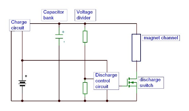

I would do it like this.
The voltage divider having a high resistance. The discharge control can be a micro controller or a 555.
That looks OK to me, however the magnet channel will of necessity be at ground potential (because it is in contact with the water), which means that the discharge controller and battery will be at -300V prior to discharge. Not a problem if it is insulated and enclosed so that there is no danger of touching it. But I think it would be better to ground the discharge controller and switch the high side of the channel, again using a N-channel mosfet (because there are few P-channel mosfets rated above 250V). Use a chip such as http://uk.farnell.com/international-rectifier/irs2153dpbf/half-bridge-driver-self-osc-dip8/dp/1271804 to drive the mosfet.
However, I don't think you will get any more drive by discharging capacitors than by a steady direct current. The MHD force is Fmag = I (L × B) where I is the current, L is the distance over which the current passes, and B is the magnetic field. So it is the average current that matters. If you use a pulsed current, say twice the current for half of the time, you will get the same force, but double the power loss due to the resistance of the water. Therefore, I think it would be more efficient to use a steady current.

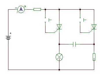

The component you are seeking is called a thyristor.

Good point, I had forgotten about thyristors. You could use a thyristor as a high side switch, and drive it from an Arduino or a 555 using a pulse transformer. Simpler than using a mosfet and high-side switch IC. The complication is that the thyristor won't switch off until the current through it falls below its holding current. You may have to turn off the charging circuitry to achieve this.
If the turnoff threshold of scr is higher than the charging current it will work. otherwise it can be done like this.
