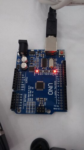

I have an Arduino UNO with Arduino IDE installed in Ubuntu 16.04, It worked fine, but once I was working with a 12v circuit and the Arduino moved (without power) to the circuit... I saw that the board turn on some LEDs (I didn't see specific ones), seeing that I moved the Arduino to a safer place... I didn't see anything burned or smell something... But after that, I tried a lot of times to Upload the code and the AVRDUDE: programmer is not responding presents! I looked in Forums and Google, I tried the reset button and unplug the arduino and what have you but none of them worked...

I also notice that even when I press the Reset button, Arduino doesn't do anything but keep the L led and On led bright... Something weird, when I remember that it blinks all the time.
Update: I have a external application to communicate with the Arduino by serial port, when I send something to the arduino, it blinks the RX what I think means that still working... Maybe something about the ISR code stops working?

I have an external application that communicates with the Arduino by Serial Port. Today, when I sent something to the Arduino, the RX led blinks, meaning that it detects the information comming, Is a IC in the board that is not the ATMega that might be broken? Definetly I'll try in another computer!
Looking at the Arduino UNO schematic, it seems that if that light is working, is that because the atmega16u2 which acts as a bridge between the usb and the actual arduino(atmega328), so that at least works. If you get the correct voltages on every output, I would say the board is okay, and that what is broken is the atmega 328. To make sure try to program the bootloader through the isp with a programmer, or through another arduino.
Diablillowilly:
