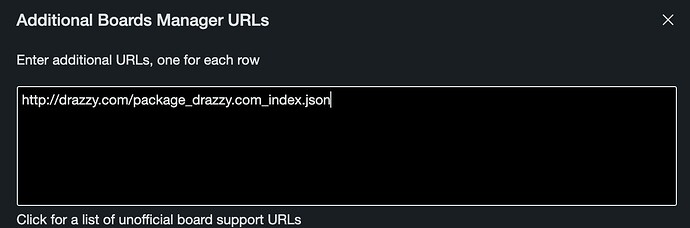

Why? That has nothing to do with the Uno R3.
Do a screen grab of your Additional boards contents. Click the icon on the right.
Based on an old thread on the same subject, this was recommended. If there is a better one, that supports R3, that would be awesome
The ATtiny board package does not support the Uno R3.

My initial research led me to the avr-gcc not being compatible with a M1 Mac. I was led to the the AT Tiny by another, now closed, thread asking about the same thing. So if that was wrong, it has nothing to do with the error

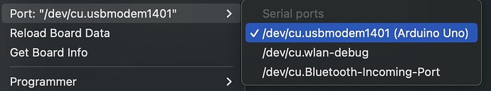

  • Connect the Uno to the Mac
  • Verify that a serial port is created
  • Select the created port in the IDE
  • Set "Arduino Uno" as the board in the IDE

Here is the port selected:
The Uno R3 is selected.

That is not any board URL I have ever seen.
