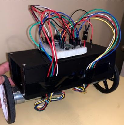

Help!! I can't seem to balance my robot. I've used several codes and several PID's, but nothing works.
Using arduino, mpu6050, drv8833, 6v motor, 6v power supply.
I need a tutor that can help me with my project. My bot seems to fall to one side, so not sure if it's too heavy and I need to change design.

Perhaps your (not geared?) motor speed is too high for balancing?
I tried 255, I tried 100, 150, but my 'box' that contains the components might be too big and all of the components do not refresh as fast to keep it balanced. I've tried a Kp of like 10-6000 and nothing seems to work.
I've tried codes with Kalman filters, codes without it.
I've calibrated the mpu to get the acc (x,y,z) and gyro(x,y,z) numbers. The setpoint I set it to about 187 which seemed to be the top spot. Besides that, not sure what all else I could do
What's that?
Balancing requires proper Kd and Ki.
You better become an expert in MPU usage before you start balancing.
Also show your device and code.
I meant "255, 100, 150" for motor speed.
Well, for Kp, Ki, and Kd you need to find Kp first, then the rest. I couldn't get a proper Kp where it would be 'stable' and not falling all over the place. That's why I started with Kp.
I did calibrate the MPU with the MPU test. My arduino crashed just now, so I don't have the actual numbers in this code below. I did the test where I left it on top of it horizontally to get the acc(x,y,z) and gyro(x,y,z)
This is one of the codes I really liked and the last one I tried. I've tried at least 10-15 different codes:

I will post wiring in my next comment. I can't post 2 pictures just yet
I'm using a breadboard, so the wiring is a little bit different (power sources)
For the mpu I'm using, I have to use the VDD to 5v and the VIO to 3.3V btw.
Let me know if the pics make sense

Motor speed can not be controlled so easily, instead the true rpm has to be measured and taken into account.
I really suggest that you master the basic tasks first, i.e. MPU calibration and movements, motor speed measured and controlled by PID, yaw angle determination and PID.
It's not a good idea to truncate a double value (calculated motor speed) to a byte without checking how far away the double value is from the byte value (0..255). A too big difference will make the entire regulator ineffective and uncontrollable.
how do I master the speed measured and controlled by PID?
Add a rotary encoder and related code to your project.
I do use the encoders already though. If you see the code,

moving the center of gravity worked, though. Thanks!
