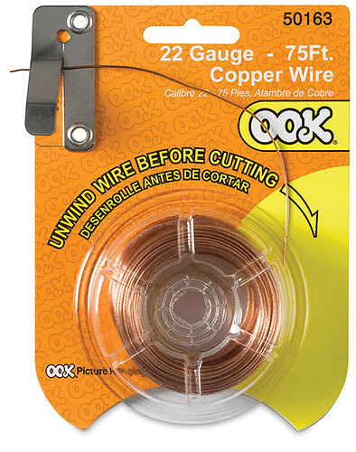

I am working on an interactive plant for one of my projects (something like this) , and for aesthetics reasons, I chose to use exposed copper wires to connect NeoPixel LEDs (and some muscle wires).
This is the one that I chose (mine are 20 gauge though)
All the wires will be contained inside a 3D printed plastic container, so no one will be able to touch the wires.
The wires won't be touching the Arduino and I will have proper wires (these) connecting to the UNO.
My questions are:
Are these wires ok for the project? Are these other things I should be worried about when working with exposed wires?
Is it even possible to work with exposed wires?
Thank you for the help!
So long as the wires can't touch, and nobody can touch them , and water ingress isn't possible...OK
Bare copper wire will corrode slowly to a dull brown in air ... if that's ok
And you have to deal with it's resistance/length ( true for any wire ) in this case 0.053 ohms per foot.

As for the OP, you can always spray the wires with clear enamel to keep them bright and shiney, as long as you don't bend the wires a lot and crack the paint.
tinman13kup:
Better (and easier) than this is to use enamelled copper 'winding' wire, intended for transformers and coils. Then the wires will keep their nice, shiny copper colour without tarnishing but have decent insulation, (and they can be bent without problems).
