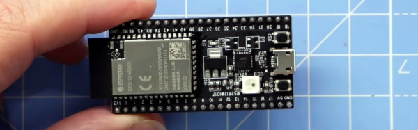

dave-in-nj:
What we as an industry are missing is an ultra low power RF module with a programmable logic and a few GPIO pins.
This is headed there...
Automatic power management that claims 5uA in idle mode and 24uA [while running the ULP coprocessor] at 1% duty cycle
