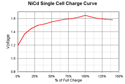

How to measure the state of charge of lithium battery ?? i tried voltage method but it has big variation

Yes look and see how successful commercial methods are, that is not very. It is an almost impossible thing to do accurately mainly because the battery characteristics change over time so it is a moving target.
I used 12 volt 4AH battery , so i used voltage divider to reduce the voltage that go to the arduino so i used 2 resistor ,
code : voltage part

Where's your data ?
If you are referring to the charging curve , yes of course it is going to vary. What did you expect ?
what should i do ?
You said you took some measurements. Where is your data ?
what should i do ?
What does this mean ?
Do about what ? (the voltage variation ?)
Was the arduino powered by the battery you were measuring ?
i didn't have the data now but this is quietly the same as data

the ardunio not powered from the battery
Next time you run the test use a terminal capture program like easy term or realterm to capture the serial monitor output and
put it in a loop.
Did you calibrate your code using a multimeter with a reference voltage ?
