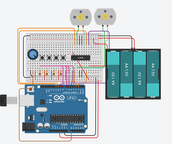

I'm trying to understand how to use an L293D as a simple motor controller, but I'm having troubles!
here is the schematic that I set up in the simulator (everything works in the simulator, but when I set it up at home it didn't work).

the link doe snot work and we would like to know what is the real setup.
  • show us the circuit as you wired it
  • how are things powered?
  • what are pins 4,6,7 and 8? (and the others?)
Is naming of port pins seams to be useful, isn´t it?
Post the schematic here. I dont want to have to create an account in order to help you.
What is the real world power supply. If it is oneof those smoke alarm 9V batteries, no wonder it won't work.
PP3

the forum says I can only post a single image at a time, so I'll use links:
Ports explained
My Circuit
Yes, sorry. In the simulator we don't use code, just boxes with parts of the code...
I can't name the ports in simulator... I still use the simulator because I'm beginner, trying to learn the codes there before I try to code my own programs!
Thanks for the help!
your images so that people don't have to click links
that's a weird looking Arduino UNO and tape instead of soldering might not work as expected
Are GND joined ?
