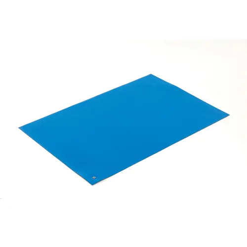

Since this bubbled back up, I did buy this mat:
It has been great ever since and never burns.

All the mats mentioned so far, starting with Crossroads, seem to be the same mat:
http://www.gotopac.com/3M_6800_Table_Mat_p/6810-3m.htm
I got mine from Global because it was cheaper than Uline and the same spec. I see it is a little cheaper at PAC but I wasn't aware of them before. It has held up very well over the last year. Impossible to burn with a soldering iron.
How did I burn my prior Jameco mat? Any solder drip would burn at least a millimeter or so into the mat. It melted very easily. With the new mat, solder just pools on top and makes a little droplet like a chocolate chip - perfectly flat on the bottom and rounder up top. Then you just pry it off with tweezers or needle nose pliers. It leaves no mark.
Wow! I guess I've been lucky with mats. Never had a drip burn a hole, even just a mm deep.
