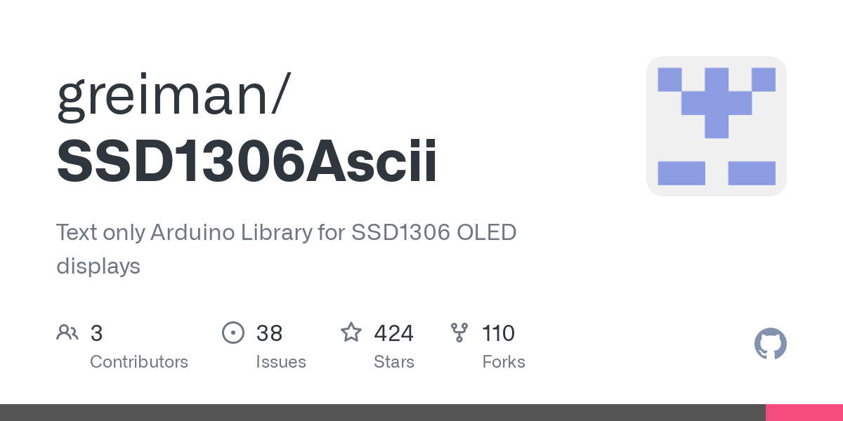

What controller?
If it's an SSD1306 then arguably the best library for text-only is found here:
It is small, supports multiple fonts (you can add more) and is well-written, documented and supported.
Thank you mr. boyton, this is exactly what i was looking for, and yes my little display is the small ssd1306. It's funny how the things I expected to be easy turn out challenging.
best,
john
Best of all, it works fine on the Nano and takes little room. Thanks again

Chris,
The Adafruit library is a graphics library. If you need to reduce RAM usage you can use the u8glib graphics library instead.
The library I posted a link to (SSD1306Ascii) is text-only; no graphics. It has no buffer and total RAM requirements are quite small, less than 100 bytes.
Thanks jboyton. I installed the SDA1306Ascii library and it works well. I especially like all the font choices! One of my applications uses graphics, but the other one (a gps) is strictly text. It'll take a bit of work, but I'm gonna convert over to the new library for that device, I think it will be a big improvement cause it'll let me put more features in. :smiley:
