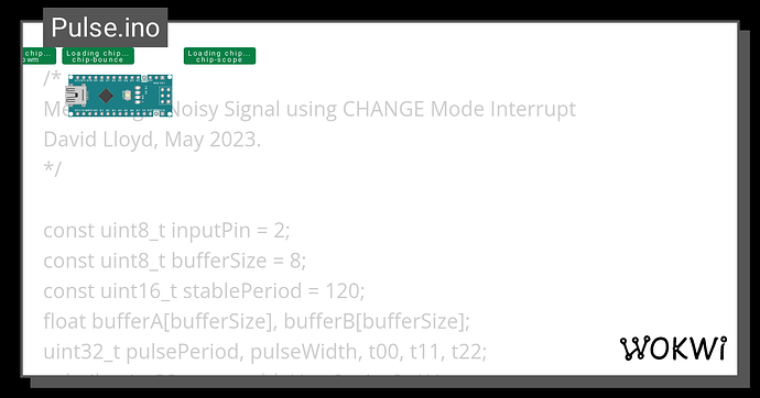

This noisy isr signal and circular buffer works fast enough for me, would be even faster with a clean isr signal ...
Hello dlloyd
Post the sketch in code tags for mobile users.
Measuring a Noisy Signal using CHANGE Mode Interrupt
David Lloyd, May 2023.
const uint8_t inputPin = 2;

Note: The circular buffer isn't required for the isr function to work, it just gives the initial ramp-up of the return value and adds some averaging to provide a response that's closer to that of an analog guage.
