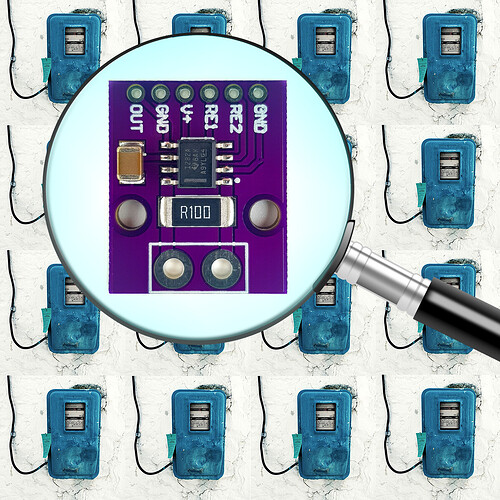

Saw this breakout suggested in this article. Would be hooking up VIN to battery positive terminal and VOUT to RAW then the GND together work for me?
No, you can't measure current by simply measuring voltages no matter what you do to them.
No, Vout must go to an Arduino A/D pin so you can measure the generated voltage in order to compute the current. At least that is by the chip data sheet. I don't know about the circuit board and what they have done to support the chip. Do you have a data sheet for the circuit board?

So I can add a resistor and connect it like I suggested before? I've realized the board must have other peripherals for it to measure voltage and current since someone has used it to measure both before: video
