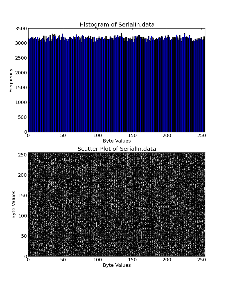

Beta testers needed for a new library that generates true random numbers
I have just published a new library that uses the jitter associated with the watch dog timer and timer one on an arduino to generate truly random numbers. Preliminary testing indicates that this library generates random sequences with far greater entropy and uniformity than either the randomSeed(analogRead(0)) method or the TrueRandom library which demonstrably does not generate true random numbers.
I would like folks to download and test the software for defects. While I have tested the software and the algorithms used on all current arduino hardware, UNO (dip and smd), MEGA (R3), and the 32u4 used in the leonardo, I would like to obtain test data from as many different examples of these chips as possible. To that end I would appreciate any an all folks emailing me (at wandrson01 at gmail.com) with screen captures of the following sketch, along with the type of arduino used (UNO, MEGA, LEONARDO, etc... along with indication if the chip is a smd or dip version). To be statistically significant the samples need to contain at least 25,000 lines of capture (a few hours run time), but 250,000 (a day and a half) would be even better. I will collect the results from these samples and publish the statistical performance on the libraries web site.
While it appears that the library is producing cryptographically useful random numbers, the test data needs to be from a much larger sample to verify that. Here is the test script I need run to collect these samples:

I have added the initial test files to the google code site for the project. Google Code Archive - Long-term storage for Google Code Project Hosting.
I have generated 1,000,000 bytes of entropy on four different Arduino's so far... Here is a summary of the initial results
ID Device Type Sample Size Entropy Chi square P-value
1 Arduino Uno R3 DIP 1,000,000 7.999797 281.39 0.1231
3 Arduino Uno R3 DIP 1,000,000 7.999819 251.38 0.5524
3 Arduino Uno SMD 1,000,000 7.999809 265.27 0.3163
4 Arduino Mega R3 SMD 1,000,000 7.999813 258.51 0.4268
The more of these tests we can run on as many sample Arduino's the better. This may be cryptographically useful RNG approach.

One more test result added for the library. While only a small number of devices have been test so far, none have failed the basic tests.
5 Adafruit ATmega32u4 breakout board SMD 1,000,000 7.999811 261.87 0.3703
While these tests have a lot of data (1,000,000 bytes), tests of only 100,000 bytes (25,000 samples) would be useful as well. Please spend a couple of hours running the test script and send me your results. In order to be confident that the library, and the methodology, are producing truly uniform random numbers we need a lot more samples from a lot more devices. In particular, we need more samples from the same type of chips as already sampled.
Do you have a link to the stuff you are using to calculate the entropy value?

I am using a python script I wrote to perform the calculations used by the ent program (http://www.fourmilab.ch/hotbits/statistical_testing/stattest.html) by John Walker. My script (attached) performs the same tests, except for the pi calculation, and combines several of the option along with producing a couple of charts of the data. I am not sure where you would obtain blocks of random numbers to mask with those produced by this algorithm, so I can't comment if it would be faster. If you need, non cryptographically secure, random numbers, that still have useful properties, at faster speeds, the best method is to use this library to re-seed the avr-libc random function whenever it has a value available. Here is a sample sketch to illustrate what I mean:

I am attaching the results of the tests for your data. This is the first sample that shows some concern, the p-value for the chi-square test is only 0.0189. Can you send me the full text on the smd chip you used for this--the label on the chip? If the mechanism is producing truly random number we should get samples that exceed the normal acceptible p-values as George Marginalia says himself in his diehard series of tests:
