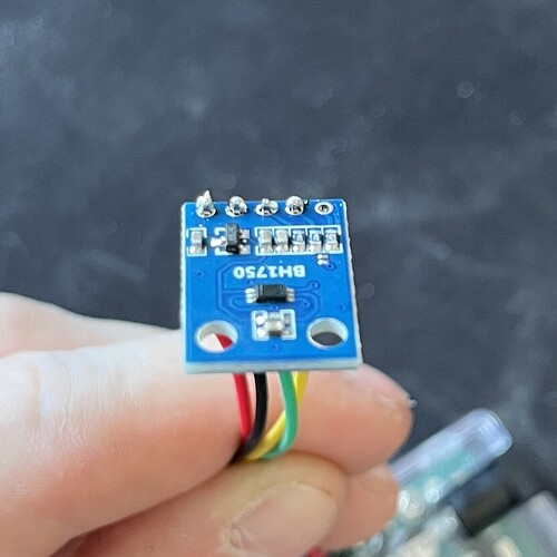

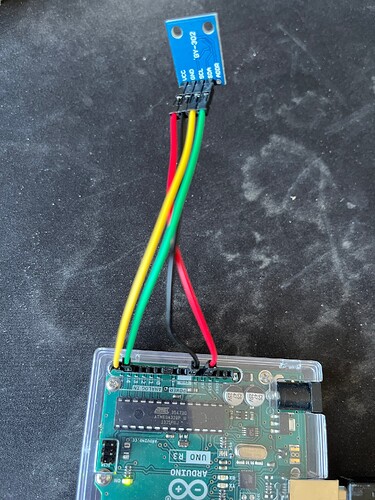

I suspected the soldering at first (not pretty), but I don't think that is the issue - tested it with a multimeter. The wiring seems also correct.

Try running the i2c scanner sketch. You should find it somewhere in the IDE example sketch menus.
Just did that:
13:47:59.400 -> I2C Scanner
13:47:59.400 -> Scanning...
13:47:59.433 -> I2C device found at address 0x23 !
13:47:59.465 -> done
This seems the wanted result...
I should add, that it's the GY302-module (no pull up resistors needed).
