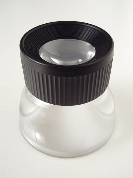

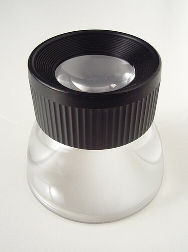

Meet my friend:
Seems like that would get in the way of the soldering iron.
I have a pair of prescription 3x reading glasses so I can solder up close and see things clearly.
