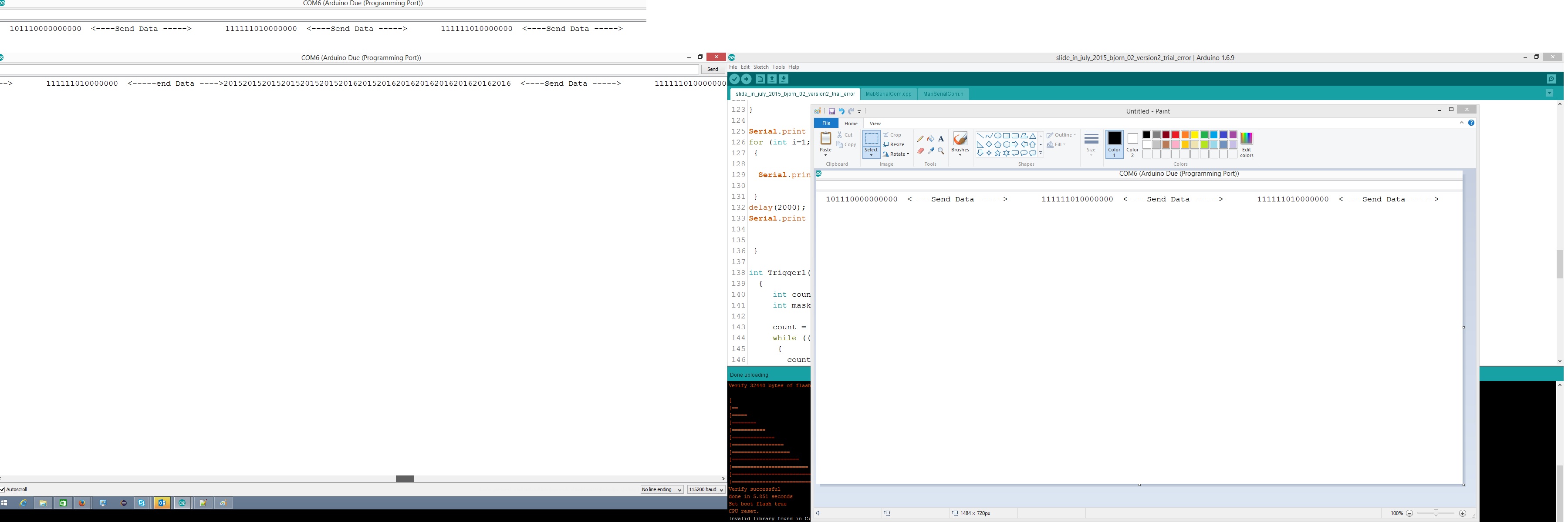

Thanks for the heads up. I actually get 15 binary sensors in the following way . In the void loop before calculating the difference as you suggested it
I do a simple Serial printing of the input from the sensors as follows
for (int z=1; z<16;)
Serial.print(Received_Binary_Bits[z]);
z++;
I get the following out put
On the serial monitor The output looks like as follows
1 1 1 1 1 1 0 0 0 0 0 --> 0x7e0
I added the code as follows
int difference = 0;
z++;
unsigned int referenceValue = 0x7e0;// Binary equivalen phase binary mapped is of the tyoe byte
if (Received_Binary_Bits[z] >= referenceValue)
difference = phase_binary_mapped[z] - referenceValue;
Serial.print("positive distance");
Serial.print(difference);
difference = referenceValue - Received_Binary_Bits[z];
Serial.print("negative distance");
I am getting some garbage values on executing the sketch. I was excpeting for each iteration , to have one value of difference in integer form based on the difference.
I am doing something wrong but unable to figure out what exactly .

Below is initial code. THe output is also attached in the picture. The first shoot is with the neutral point commented.

Thank you for posting complete code and using code tags.
Serial.print ("  <----Send Data ----->       ");
for (int i=1; i<16;i++)
  Serial.print( Received_Binary[i]);
As I understand it, this is printing out 111111010000000, and this is supposed to be the extracted 15 bits from the complete port reading. According to the previous postings, the 0 at bit#8 between the two ones should not be present. Is that correct? For this test, should you be reading 111111110000000?
Are you sure that you have the correct input to the pins? If the input is correct, than the extraction program is incorrect. I have not examined your code in detail, but I know the extraction can be tricky given the pin arrangement on the ports of the Due.
