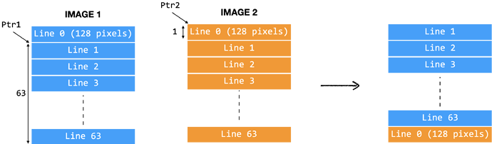

Looking for a bit of direction. My objective is to display bitmaps on a 0.96" OLED, scrolling when I transition from one to the next. They will transition only when there is an input, and always in the same sequence. I have 26 images that I want to display. Each bitmap is the size of the screen (128x64). When I get to 26 I'll want to start from 1 again. It is a constraint that they must scroll not just replace. Therefore I will either be statically displaying one, or showing a bit of 2 of them when its moving. I've got all the bitmap arrays stored in PROGMEM and they display OK.
I currently have some I2C displays and they work fine - I am not sure if there will be speed issues with these, but a slow smooth transition is fine for my purposes.
My questions are : is there a library out there that would support this ? Could someone point me to a description of how scrolling is executed? I'm assuming it updates column by column, so if I wanted to control this myself I'd move the end-1 column to the end, the end-2 > end-1 etc and eventually add new data into the first column?
Any pointers gratefully received.
Please post your sketch that displays a singe static image but also contains the data for a second image
do you want scrolling from left to right or top to bottom?
+1 on posting your code and a couple pictures
On the scrolling - I was assuming L to R although any direction is fine, as I will just orient the display as required. Code inbound in a bit for my 4 OLED display (its using aTCA9548A I2C multiplexer btw).

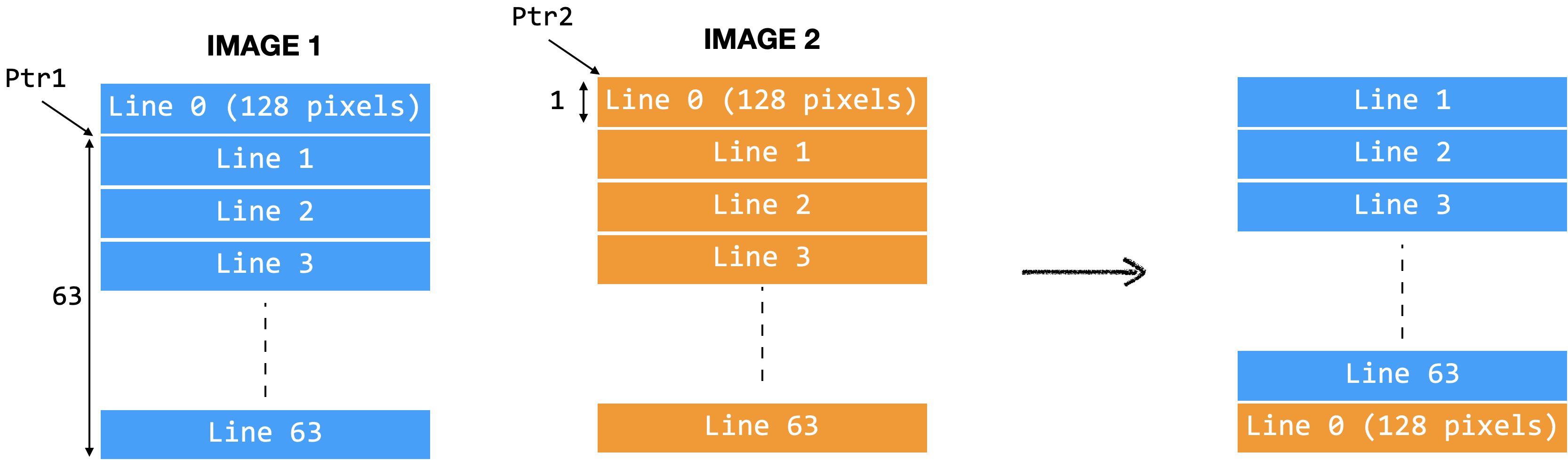

to answer your question, to draw the scrolling image it depends on the hardware
some support messing around with the framebuffer, so you would translate the content in one direction and then paint the missing line or column. That would be the fastest way probably but I don't know if your screen offers this capability.
otherwise you have to paint part of the screen with a decreasing part of the first image and the other part of the screen with an increasing part of the other image and repeat until the first image is gone.
this can be done in different ways.
If the bitmap organisation in memory is line by line and you scroll vertically, then it's easy as you don't need to mess with an intermediary buffer
When you want to start scrolling, You ask to paint at (0,0) a bitmap which starts at the second line of image 1 and is 63 lines high and then you pain at (0,63) a bitmap which starts at the beginning of image 2 and is 1 line high
then you repeat and ask to paint at (0,0) a bitmap which starts at the third line of image 1 and is 62 lines high and then you pain at (0,62) a bitmap which starts at the beginning of image 2 and is 2 lines high
rinse and repeat until the first image is gone
if the data is organised by columns in memory then it would be better to scroll horizontally
if you want to scroll differently then you need to build an intermediary buffer that you fill with the relevant bytes of both images and then push that buffer to the screen. That would be the slowest version as you need to move lots of bits around.

     for (currentYloc0=0;currentYloc0<64;currentYloc0++)
  // for each vertical line draw the first image at the same point, starting one line lower
// and draw more lines from the second image underneath, starting one line higher
   display0.clearDisplay();
   display0.drawBitmap(0,0,logo_bmp+(16*currentYloc0),128,64-currentYloc0,WHITE);
   display0.drawBitmap(0,64-currentYloc0,yRose,128,currentYloc0,WHITE);
   display0.invertDisplay(false);
   display0.display();
//now swap the images around and it appears to be a continuous loop
  // Set text size multiplier (x1 standard size)
   display0.drawBitmap(0,0,yRose+(16*currentYloc0),128,64-currentYloc0,WHITE);
   display0.drawBitmap(0,64-currentYloc0,logo_bmp,128,currentYloc0,WHITE);
   display0.display();
 //delay(100);
