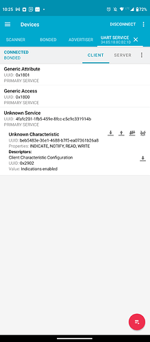

The resulting service and characteristics show completely different UUIDs on the NRFConnect app. It also has a wrong PROPERTIES, shows all of them, and instead of 2 there is only one characteristic.
Which is why the logger app does not detect it as a UART enabled device.
What am I doing wrong here?
I can not confirm your issue. I see this screen in nrf connect and see the TX characteristic being updated. I have seen instances where older connections are not cleared but don't understand when/why.
Perhaps try using Light Blue which I find easier to use than nrfConnect.
Hey @cattledog ,
Thanks for verifying that for me. It is really strange, I ll give Light Blue a try. Thanks
regards
Anil
