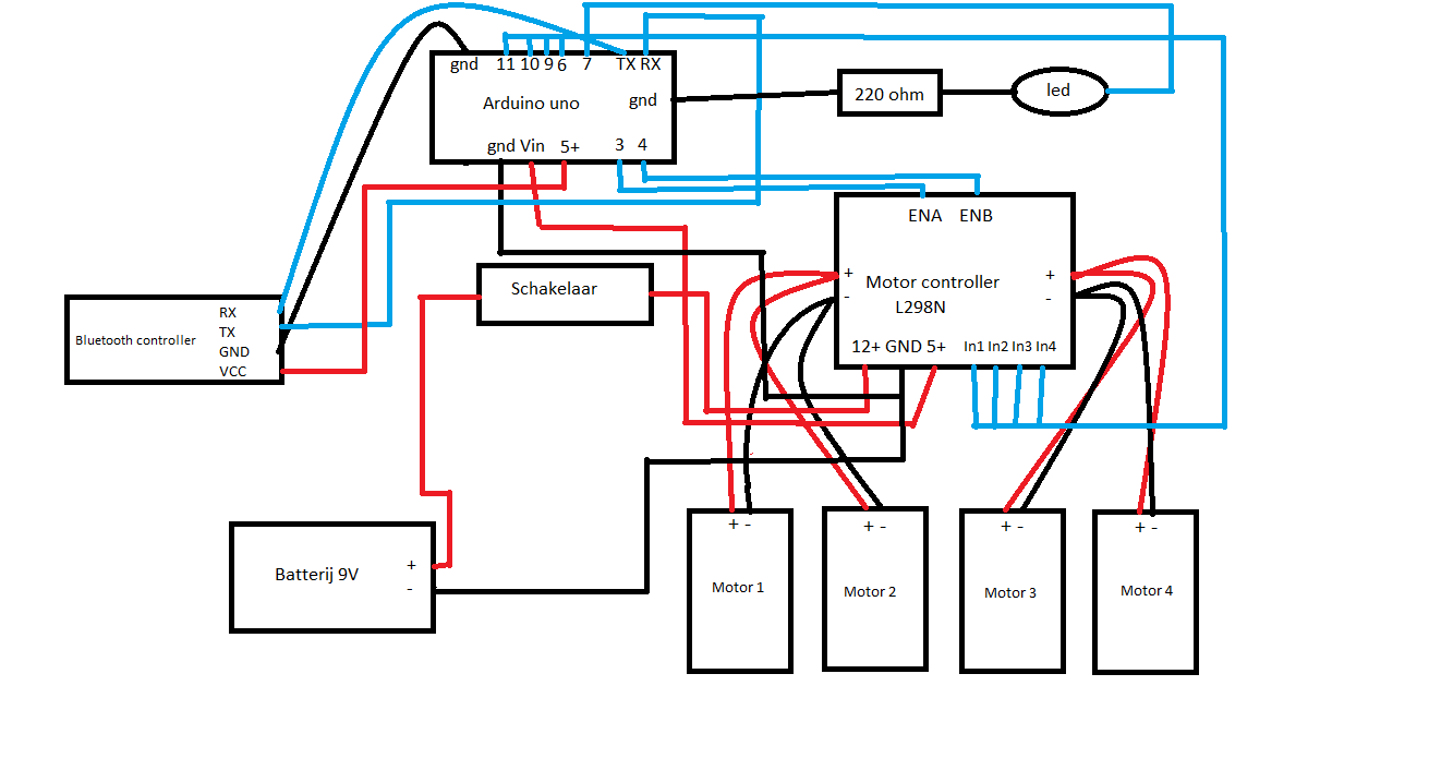

Thank you for answering my left and right works now but when I click 1 time forward, backward, left or right on the controller app it executes but then it blocks and loses connection with my HC-05. Do you know why this is happening?

A loss of connection would indicate that the HC05 is losing power during some brownout event with the Arduino when the motors run.
How is everything powered and wired?
Here is my wiring diagram. I know it's not the prettiest because I made it in paint. the 4 input needs to be 5
As previously stated, the only way the phone can disconnect from the HC05 is if the module Vcc drops too low when the motors run.
You can not power an Arduino with 5v on the Vin pin. That pin is before the voltage regulator and requires at least 7 volts. Using the 5v output from the LN298 to power through the Vin is not correct. Better would be to take the 9v of the battery directly to Vin.
Explain more about the 9v battery. What kind is it and what current can it supply.
With an adequate power supply to the Arduino, the 5v pin should work fine as Vcc for the HC05 module.
My HC-05 no longer loses the connection because I connected my arduino directly to the 9v battery. Forward and backward now works perfectly but if I want to go left and right my motors need more power to turn but if I give my motors more power by increasing my analog power to 200 it still loses the connection. The battery I use is a Panasonic Pro Power 9v battery. Do you recommend another battery? Thank you so much for all the help
