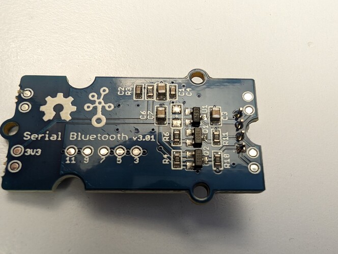

Several things could be wrong. First check your wiring against the Wiki - twice. Note that, while the AT commands in the Wiki suggest it might be a BLE, i.e. BT4, device, your Bluetooth v3.0 appears to be a plain-vanilla HC-0x BT2 device, repackaged, and with an extra coat of technobabble. It seems that you are unable to put the device into configuration mode, AT mode, and then make the changes you require. On typical HC-05 modules, this involves pushing a button. On this one it may involve a 3.3v signal on one of the pins. It is far from clear in the pretty useless Wiki, which apparently assumes you already know how to do this, but there appears to be a users' forum that may be helpful.
I raise this because there is no claim in the Wiki that it is a BLE device.
The code per se is pretty ragged but it should work - with the right module, hence my comment about the wiring. The main problem with it is that it doesn't provide any feedback, which is OK if you know what you are doing, but not OK here.

Thank you very much @Nick_Pyner . The module should be "old school" Bluetooth (2.0).
Iiuc BLE would need some kind of vendor specific serial over BLE library and there'd be a deep rabbit hole to go down on it's own getting that working. So I was looking for a "transparent" solution. The wiring to the Arduino Mega2560 is correct as my code works at 9600 and transmits between the two.
On the seeed page are two data sheets, a general one about the HXxx modules in which no photograph agrees with my actual module and https://files.seeedstudio.com/wiki/Grove-Serial_Bluetooth_v3.0/res/Bluetooth_module.pdf which is about the module installed on the seed breakout.
On page 9 is a badly scanned schematic with a part (bottom right) which says baudrate select, no indication given which pins this should correspond to and totally unreadable which baudrate corresponds to which pull-up/down :crazy_face:
(counting on the schematic, this corresponds to pins 25-27, which are just indicated as GPIO in the data sheet...)
I have continued searching for a better picture of the schematic or the data sheet in general, but to no avail so far.
