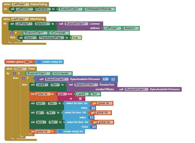

I am trying to send data over bluetooth and receive data in the app from 3 sensors. The sensors are not connected for this test because I am trying to fix the app and bluetooth at the moment.

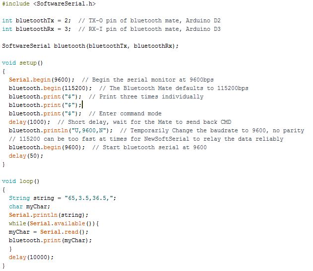

I attached the app inventor blocks jpg for background knowledge, but I'm worried that the arduino code is wrong as I'm unsure if Serial.read() is sending all the data.
Nothing is showing up on the app and I'm not sure if the bluesmirf is sending data. Is there a way to check it is sending data correctly?

Sorry, I uploaded a jpg of the code for some reason!
I have Serial.read() printing from bluetooth.print right now

SoftwareSerial won't work at 115200 baud. 38400 is the best it can do I believe.
If you can't change the Bluetooth baud rate then maybe you could connect the Bluetooth device to pins 0 and 1 and use a USB-TTL cable connected to the SoftwareSerial pins to communicate with the PC at 9600 baud.
Or use an Ardduino Mega which has 3 spare HardwareSerial ports.
...R

I have the code at the beginning which changes the baud rate, changing it in command mode didn't help either.
I included the following in setup according to the hookup guide.
bluetooth.begin(115200);  // The Bluetooth Mate defaults to 115200bps
 bluetooth.print("$");  // Print three times individually
 bluetooth.print("$");  // Enter command mode
 delay(1000);  // Short delay, wait for the Mate to send back CMD
 bluetooth.println("U,9600,N");  // Temporarily Change the baudrate to 9600, no parity
 // 115200 can be too fast at times for NewSoftSerial to relay the data reliably
 bluetooth.begin(9600);  // Start bluetooth serial at 9600
[/code]
Well I got it to receive data on my app with the following code, and I think I will try to follow suit with the sensors. Thanks Robin2 for your assistance while I learned how to use the forum too.
  bluetooth.print("65,3.5,36.5");
  delay(10000);
I don't think this will work
because it relies on SoftwareSerial working at 115200 baud to send messages to the Bluetooth device to get it change to a lower baud rate.
