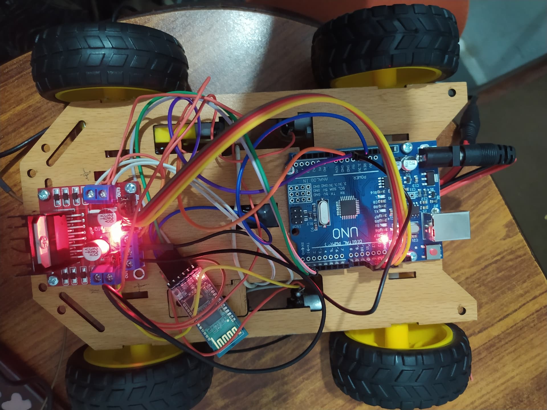

The car is full of faults :sob: idk why I decided to make this. I feel dumb asf. Idk whether the code that website gave me was right or wrong. I just wanted to build a Bluetooth controlled car because it looked cool. So I did whatever was mentioned in the website.
https://create.arduino.cc/projecthub/samanfern/bluetooth-controlled-car-d5d9ca
I used:
arduino uno board,
hc-05 Bluetooth module,
L298 bridge motor driver,
and 12 V battery
Dc gear motors
Before it was just the delay causing problems but now only two of my wheels are working. Like if I stop the two forward wheels the backward wheels would work but if I press the forward button on the mobile app only forward wheel work not the backward wheels when in fact both should work. I feel like maybe the wires are broken from inside??
There's also one more I did that is not from the website and that is that I connected the battery to arduino directly and soldered motor driver to the battery. It is my first time soldering.
Please see the image I'm attaching.
Please help without making me feel more dumb than I already am feeling :sob::sob:

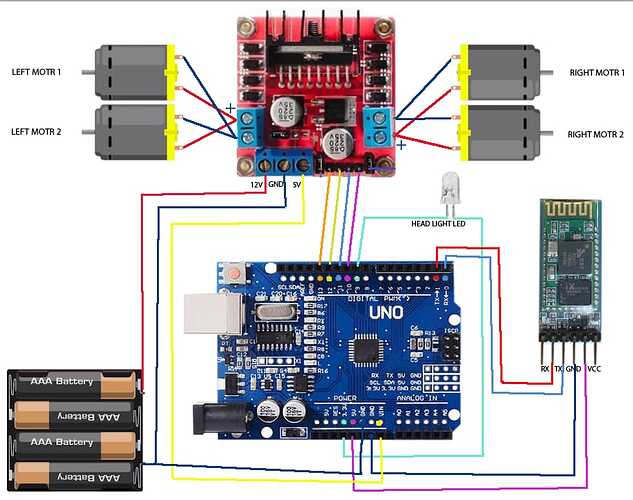

The circuit I was supposed to follow
Don't be too hard on yourself. Projects usually don't work as expected at first go, and working your way through this will be a good learning experience.
It's best to break the project down into smaller pieces.
I would recommend that for development you disconnect the HC05 and take your input from the Serial monitor. Once that is working, substituting bluetooth over the serial port is trivial.
You need to verify the motors work with simple test code to just run the motors.
You shouldn´t. Each one of us started once and chose to do much more easy-to-do projects.
I agree with @cattledog on trying to accomplish smaller steps. But looking at your picture, looks like you´re feeding HC-05 module with 3.3V (blue wire). That´s not enough. This module requires at least 3.6V to work properly. Take a look on that. :wink:
If this works, be aware that RX line of HC-05 is 3.3V. Then you should use a voltage divider or a logic level converter on this line. It might work without it, but there´s a risk in burning out the HC-05.
