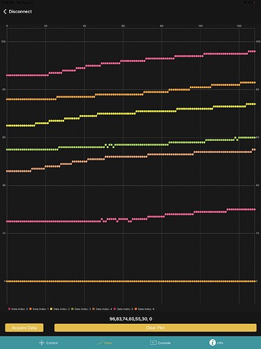

Aarg and Jremington, I have read your responses. My data collection requirement is mobile, so using a proper PC + serial port isn't practical. Agreed, there isn't a stitch of documentation for BLExAR, only limited examples, and actually there isn't a single example that demonstrates how to change plot colors although there is one picture that shows two colors. The Maker engineer told me that comma delimited data can change colors and this works beautifully. I'm inserting an example trace showing 7 independent graphs.
However, note that this is exactly 20 characters of data, and what it represents is temperature from 6 DHT11 sensors, plus a control output. These sensors also provide humidity data, and that is the reason why 20 characters isn't enough. I need 5 sensors worth of humidity data which brings the string length to 35.
Maker is telling me that only a single string sent as such can achieve a plot like this. They are also saying that the BLE module is breaking up the string at 20 characters, which they have no control over. This seems to make sense because the BLE spec tells us there is a limit at 23 characters (the MTU).

cattledog, breaking up the data into sub-20 character lines just makes the graphs into a mess. The data sent just looks like this:
84,85,84,85,84,85, 0
45,45,45,45,45
The resulting graphs are a mashup.
