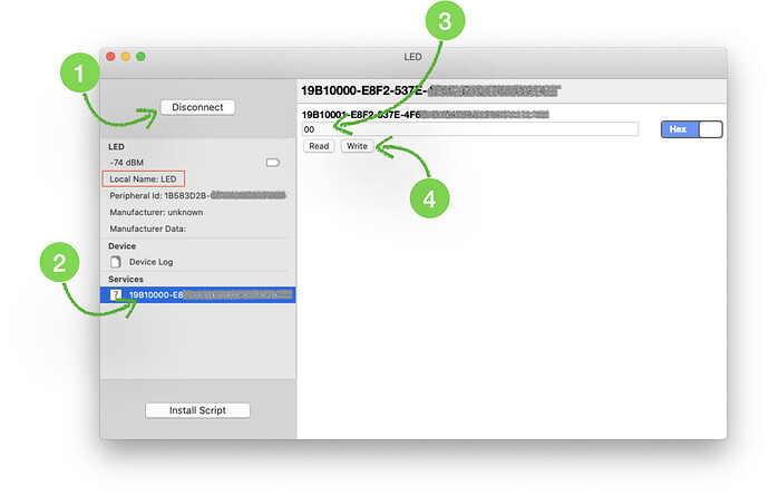

for example If I upload the ArduinoBLE library example Peripheral/LED/LED.ino to my Arduino Nano BLE Sense and then open BlueSee (on my Mac, exists on Windows I believe) then I can see a device named LED.
if I double click on it to open it's inspector and connect then I can see the characteristic the device advertises and read or write it. if I write 01 then the LED on my Arduino turns on, if I write 00 then the LED turns off.
1: connect
2: select the characteristic
3: enter 00 or 01
4: press Write
5 -> see light changes on your Arduino Nano BLE
basically you would need to write an app on your PC doing something similar. Connecting through BLE to your Arduino and read the data every few seconds. There are various ways of advertising data changes whilst you are connected.
