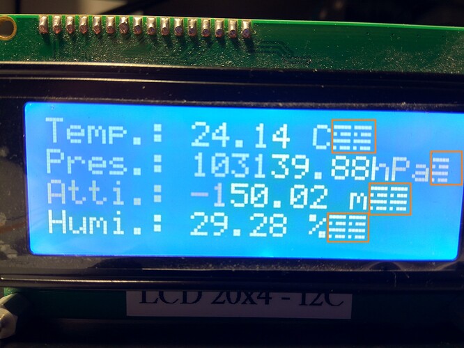

Could you please tell me how to erase 2 stranged characters in the end of each line on this LCD-20x4 ?
See Photo attached
Thanks
Do not use println() on LCD but print(). What you see are characters 10 (LF) and 13 (CR).
I found... bc I use println("%"). Thanks.
