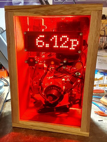

Compare the two sketches?! I lifted the dozen lines of the functional sketch VERBATIM. I added one #include. The wiring is correct because it works perfectly under the TWOWIRE test.
The module has for lines. vcc, gnd, sda, sdc. no jumpers, switches, or wiring options.
I posted 2500 lines of code because I was told just posting the added code wasn't sufficient. And now your only advice is "compare the code"? That is NOT helpful. I understand you're a boss here, but have you any more practical advice other than "compare the code"? I posted the ENTIRE "two wire" sketch here. A pointer in the right direction is what I need, not a generic non-response "compare the code", don't you think that I already thought of that?!
I have a four wire +5vdc module. vcc, gnd, scl, sda. No jumpers, no options. it works when i run the TWOWIRE diag, but when i copy to the larger sketch the sketch DIES.

From my experience that mess cannot work as a system unless the OP plans to gradually reduce the jumpers wires by putting the modules onto a PCB.
You mean like THIS?
Everything is mounted on a panel with a holder, the wiring is neatly dressed out. This is the dev box. All the stuff that is hanging loose will mount on the front panel, that is why they have long service loops. The power leads are all soldered and the signal leads go into the terminal shield.
The cables use HS tubing to separate out power and signal leads. Everything is covered in HS tubing so there are no exposed pins anywhere. Cable ends are labelled and each device has a 3D printed mount.
Just what exactly would you do differently?

Thats a great idea, but the devices don't have mounting holes. You can't solder the module to the bread board without a cable since there would be no way to replace a module without unsoldering and possibly causing more damage. The panels need to be separable and each module needs to be swappable without soldering. This is important for long term maintenance and servicing.
Additionally several of the components need to be oriented looking one way or the other. The IR, the LED matrix, the traffic light, the LDR. The buttons and pot all need to be on the front panel looking out.
Great plan for a home project, but not really practical for production.
How do you mount speakers and what do you do for power distribution? How do you label connectors? How do you connect from the perf board to the CPU? Still use the terminal shield or straight into dupont pins?
What makes you think I haven't been adding one item at a time already? How do you think I got all this stuff working as well as it does? The BME280 was just the latest item to be added. Do you expect me to build a completely new system every time a part that I try doesn't work as expected? How do you swap modules for test?
These are going into limited production for sale in stores. They MUST be self sufficient in that once programmed, it NEVER has to be plugged into a computer again. I'm trying to build an appliance, NOT a "one off". Gotta plan for manufacturing even in low volumes. I can't fly out to solder a replacement whatever, but I can mail a module that the user can change with just a screwdriver.
