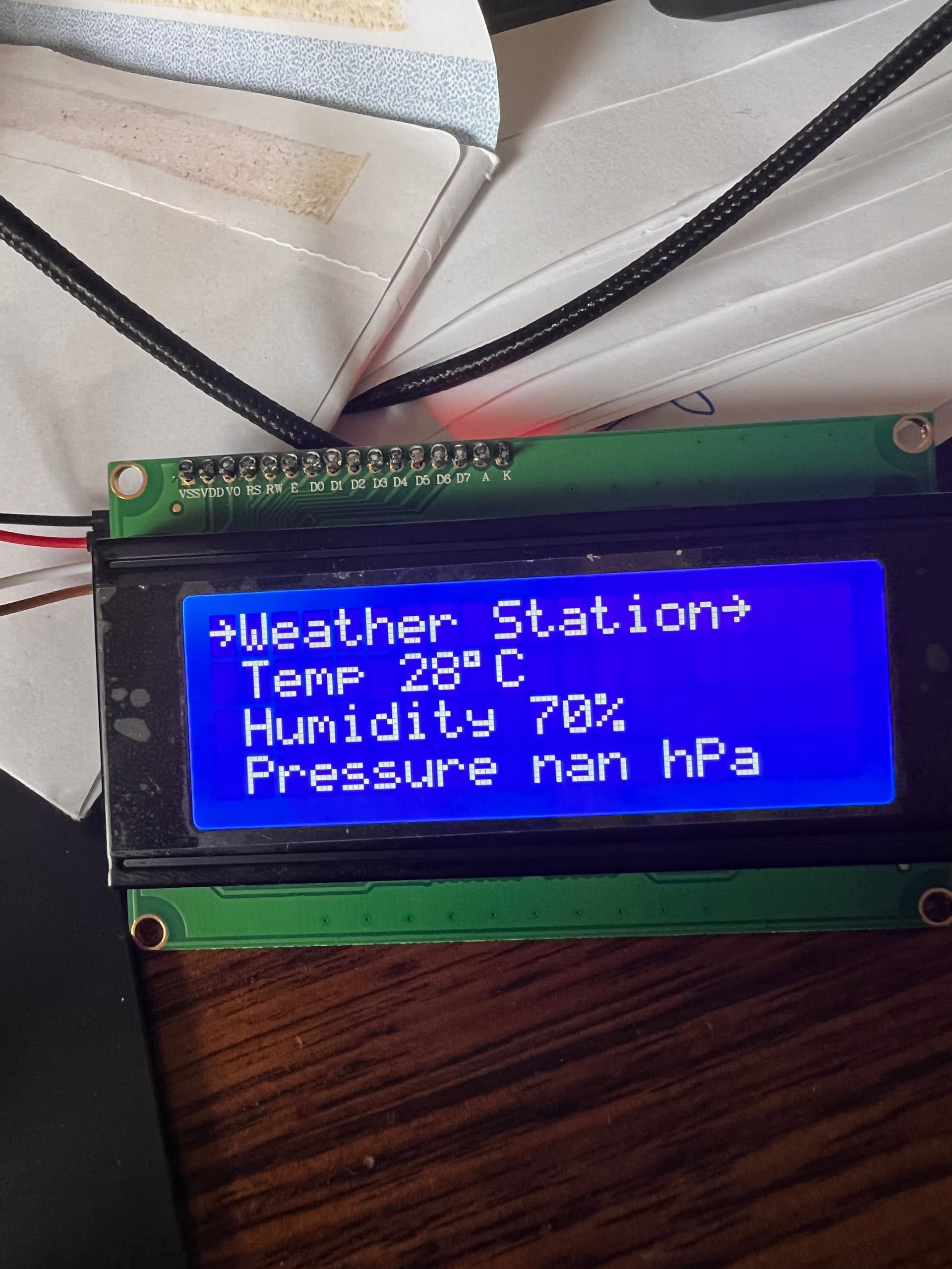

HI all , me again! I have spent the day tweaking some code in the DHT11 sketch and this works fine. I have written the BMP180 sketch separately, though using this and a number of other sketches found online I still had issues getting the serial or LCD output right.
No matter what I try I get nan C or nan hPa on the output (nan = not a number?). I have Googled this for hours and tried different approaches. I finally have the sketch at the point where I no longer get errors returned compiling or uploading so the code "sounds" solid. FYI the hardware is an Uno, with a DHT11 and BMP180 with an LCD 20x4 display. Temp and Humidity off the DHT11 report accurately, but the data from the BMP180 reports as "Pressure nan hPa" on the LCD.

This is what the LCD looks like. The temp and humidity are read from the DHT11. The Pressure is from the BMP180 and that’s what gives me an nan hPa reading

It does but only if I am using the SFE_BMP180 library. With the Adafruit ibrary it just keeps saying device not found. However, the output in serial monitor is just something like:
Temperature nan C Pressure nan hPa Altitude nan metres
Where there should be numbers there is only nan. And I have tried every single script I can find and none of them work.

No I still get the nan for all the outputs. I’m thinking it could be a faulty device?
I have bought a new one and still have the same nan output. Interestingly the BMP180 library recognises it using the SFE library, but printed on the bac k of the module is SPL06/BME. Should I be using different libraries?
I am using that library but I still get the nan output. The I2C address is recognised in the I2C scanner and has been changed in the respective library files. Would I not be getting data from the I2C in the serial monitor if it is giving me updates even if the reading itself is nan?

It still gives me a nan output for the pressure. I’ve bought another sensor to make sure the original wasn’t a dud and still get the same output.
I still use a dht11 because that gives me humidity too which I can’t get off the bmp180 (plus I can’t get it to give me anything but nan!)
I don’t use adafruit because that library tells me the sensor can’t be found even after manually changing the module address in the library. Attached is a picture of the project.
The Adafruit library may be giving you the correct results.
When you ran the I2C scanner on the BME180 what address was reported?
0x76 was the hex address from the scanner. That matches the guide from the manufacturer also.
