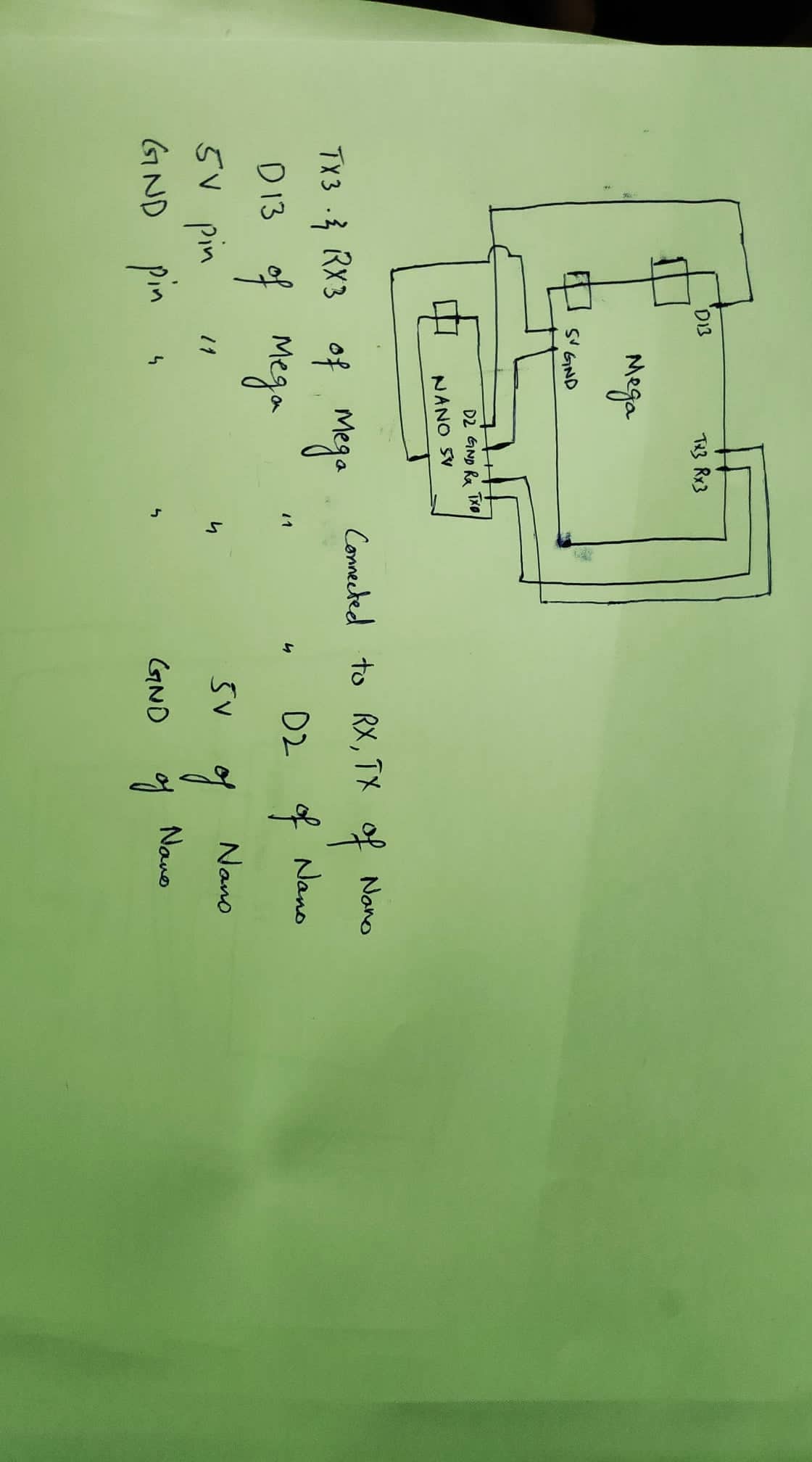

I have a circuit which uses two arduinos( mega and nano). These two boards communicate via serial as well as through some digital pins to each other. Both boards are powered by one 5v regulated supply connected to 5v pins of both boards. But the problem is I want to communicate with arduino Mega through usb on serial monitor. Now problem is if i don't remove 5v supply to mega and connect it to usb, my laptop does not recognizes usb port( so I can't communicate with laptop) and if I remove 5v supply to mega and connect it to usb then phantom current passes from arduino mega to nano until nano turned on via power supply. So I need suggestion for board that if I want system to work normal on 5v power supply it take power from that and If I want to communicate to Mega, both controllers(mega and nano) get powered by one usb so there is no mismatch of timing of power on of both controllers.
I first thought that if will connect pwer arduino mega through usb then it will be able to power nano through its 5v pin but it does not. So I am clueless here.

I will rephrase my problem to make it more clear.
I want to know if it is possible that both boards could be powered simultaneously either through power supply or through usb. If i want to debug system I pull jumper from main power supply and connect mega to usb and both controllers get powered by usb and after debugging I remove usb and put jumper back and both controllers start getting power from 5v supply.
Do post a schematic drawing of what you have in mind - that talks a lot easier.
I think it's possible to do what you have in mind, but not sure based on just the description.

uploaded the picture

Power supply is connected to 5v pins through jumper. I taught this was obvious.

ok then
will this help
If you wire GND of the Mega and Nano together and 5V from both together then 1 supply may run both as long as it has enough current. Standard 500mA USB has the current. If you have 1 board with both chips they would get common power.

I don't know why I could not clear my self. both controller work fine together on 5v supply ( That is not the issue). But I want that if I pull jumper to cut supply of both controllers and insert USB port in mega. So I could debug the system as well as power both controllers from one USB connection to mega so there is no chance of phantom current passing( because if I will only power mega from USB and nano from 5v input then there is always chance of phantom current)
Phantom current? The USB 5V is not the same as the power supply 5V? One is higher than the other, maybe 5.5V?
What I suggest is powering the Mega and using Mega 5V and GND to power the Nano, whether the Mega power is USB or plug-in supply or batteries.
OP's schematic:
That's a lot clearer. Especially as it shows that mysterious jumper you were talking about.
The USB is connected to the 5V pin (I remember there's a polyfuse and a MOSFET for power selection in the path as well - check the schematics for details - you can pretty much consider this a direct connection) so this way when you have the USB connected to the Mega, the Nano will simply be powered through the 5V pin of the Mega. No problem there as long as there's not much else connected to the Nano.
You are right. There were 5v available on mega 5v pin which were enough to derive nano too. Thanks for clarifying. I checked on nano board. It was not giving 5v. May be nano have different circuit.
