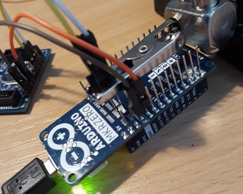

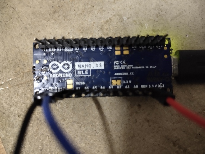

I wonder if it's possible to connect VCC、GND and RESET with corresponded pins on 33 BLE, which I am more likely to make it. Is there potential danger?
my way for this contact points.
Nice one Juraj! Which programmer/debugger is that you're using?
Jim_Leung:
Yes. You can connect VCC to the 3.3 V pin, GND to GND, and RESET to RESET. Then you only need to connect SWDIO and SWCLK on the test points (since those are not broken out to the normal pins).
pert:
NXP LPC-Link2.
it was available locally and has the cable with the small SWD connectors for my M0
Looks nice, with a good price too!
