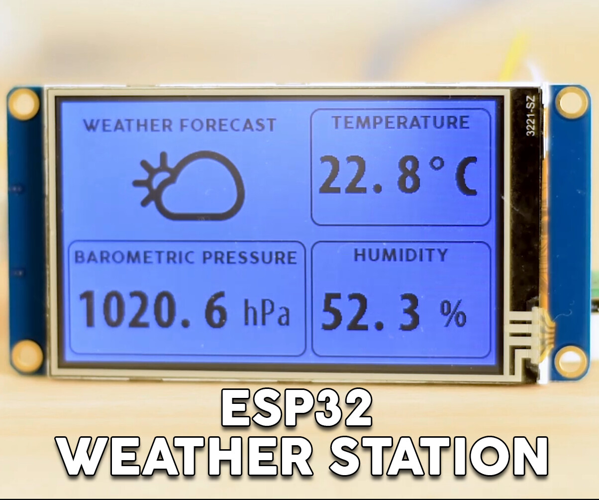

Have the little weather station code in Arduino IDE and it won't compile. Either by upload, or compile and check. But I don't see that board in the boards set up. Or it's there and I don't recognize it as such.
