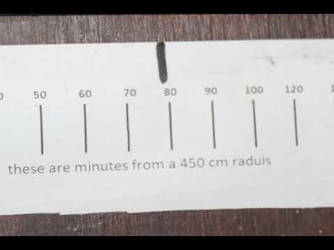

I have a laser on a huge compass needle. I have a radius of fifteen feet. Is magnetic north moving? Speed and even sensitivity do not seem to be issues. My preliminary data indicates that I need a broad range. And high precision, at least for now, is not critical. I need the 54 digital I/O pins from the Mega 2560. That is the constraint. I understand what you mean by “it is entirely about pin voltage”. I suspect that the LDR will not give a voltage high enough to be Boolean HIGH. I just found module LM393. One module for each LDR? Maybe. Maybe there are tricks with resistors to bring the LDR output up to the HIGH/LOW range.

You are telling me that tricks with resistors/ voltage dividers should work. cool. The laser beam has a 450 cm radius. I have a scale in minutes, where 60 minutes is a degree. My preliminary data regularly shows ten minute variation (about a centimeter) .... (GitHub - mrphysh/magnetic-north: Is magnetic north constant?)

pi * radius / ( 180 * 3600 ) gives me arc-second tip to tip.
Is the radius 450 cm to what measure error/tolerance?
Edit Arc-minutes is less insane. I went for mm.
pi * 4500 / ( 180 * 60 ) = 1.31 mm rounded.
“to what measurement tolerance?” Never been asked that before. The 450 might have an error of 10%.
I have been banging around like this all my life. I have never had a peer review. Your mathematical approach was certainly more elegant.
Is your compass inside with low lighting or outside in the sumlight?
in a basement. The light is completely controlled. I know that the LRDs do not respond well to red light, but I think they will be fine. This latest prototype has the laser on the compass needle.
