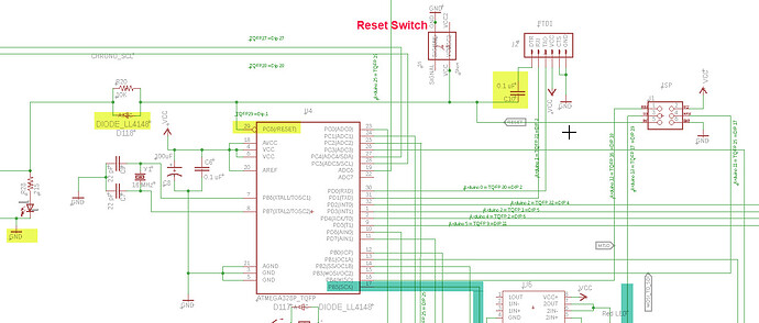

I know this is a very old thread but it is the best answer to the upload problem due to the reset circuit.
I have followed Paul__B 's advice and I am perplexed: It works sometimes.
Specifically:
Built a board using Atmega328PB
Bootloader burned via ISP using AVRISP mkii. Works great. Using MiniCore so I can select my exact chip Atmega328 variant PB
Upload via FIDI.
Problem: Works first time and multiple times afterwards. Sometimes. Then it may not upload, getting the usual sync error. Then it works.
Works intermittently, like my schematic is close buy not quite right.
If I press reset button it does load every time.

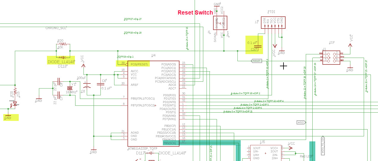

My schematic is attached. Is there something I have wrong? Wrong value on a cap, wrong diode?

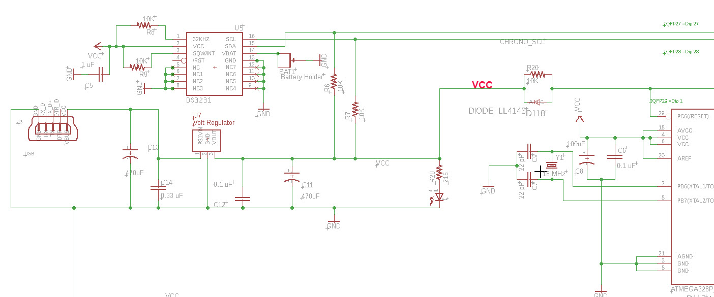

Left Side of Schematic attached
](Bootloader Overwritten by Regular Sketch Upload - Project Guidance - Arduino Forum)
RichKC24:
I would be wondering what that mysterious wiring is to the reset pin that has been cut off the left hand side of your schematic?
Paul__B -
It is going to VCC. I added the left side of schematic in original post.
Can't see a problem here - so it works with the pushbutton but not with the FTDI.
I suspect the FTDI! :astonished:
Do "SIGNAL" and "VCC2" connect to anything?
AVCC should not connet to VCC directly. Only have a 0.1uF to Gnd.
Schematic looks fine otherwise.

Paul__B: Yes works every time wiht the reset button. Thanks for reviewing the reset circuit. Good to know it is right, I have been wondering. I will try another FTDI, also wonder if my computer's USB port is getting flaky/worn contacts.
CrossRoads:
Reset Button pins Signal and VCC2 do not connect to anything. Since they are connected internally to GND and VCC I thought it would not matter.
AVCC on Atmega328 - "Connect to ground through 0.1uF to Ground" like this?
Regarding using a chip with Analog input 6, I have MiniCore installed on the Arduino IDE so I have not selected Board Uno but it set to: Board - ATmega328 Variant - 328PB. Will this solve the problem regarding changing to "uno.build.variant=eightanaloginputs" ?
