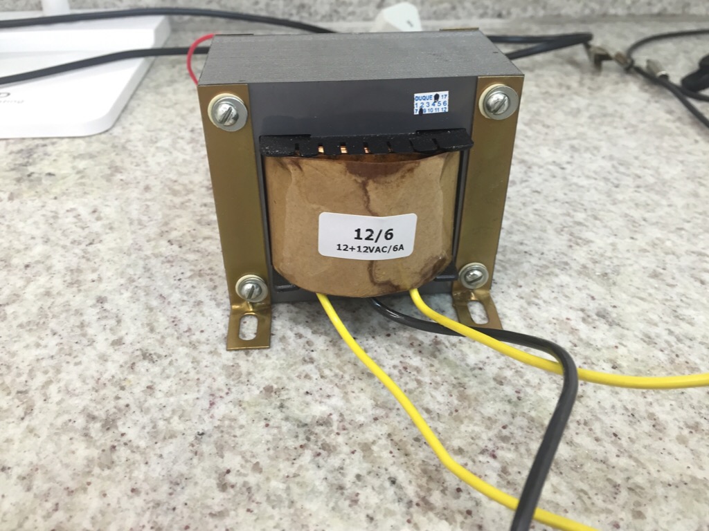

It needs 24V AC, so I bought a huge 12-0-12 6A transformer
I don't know how much of this 24V AC inside the control box gets transformed into DC, and how much of it powers the bldc..
