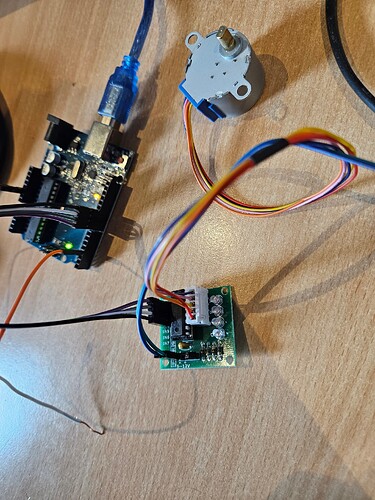

Well I'm almost there, if it weren't for the fact that the engine starts turning on its own after 30 seconds being not used... the CW and CCW works with 1 button...
anyone who can find that bug please?
That's not apparent from the code. It may be useful to have a look at your hardware setup. Could you post a schematic diagram and a clear photograph of how you've connected everything together?
As a button I tap the wires GND and 3 together :slight_smile:

Thanks gcjr in advance,
do you have this hardware? Normally I think you should have the same error with this program. I'm afraid it's not the hardware but a writing bug
Why are you writing to your switch pin?
Btw, this doesn't explain the odd behavior after 30 seconds. This may be something simple like a bad connection in your wiring somewhere. Those DuPont style connectors tend to dislodge kind of easily.
Also, please remember what both @gcjr and me said about debouncing. It's relevant. Please give the code @gcjr provided a try.

I understand this, learning it myself until I can write such programs is not easy. Been working on it for a few days now and cutting and pasting works. I find this interesting, but it is only for 1 project. Unfortunately, spending weeks learning how to do this is not an option and my efforts and purchases so far are wasted.
Still, thanks for your time so far
I understand. Well, Arduino is relatively user-friendly, but not quite as user-friendly as assembling an IKEA Billy cupboard. I hope you find the willpower to persevere, or otherwise the peace of mind to come to grips with your sunk investment. Good luck either way!
hihi, If a professional like you doesn't find the bug in the program, I guess it's not that easy after all :smiling_face:. That's already a reason why I won't delve into it further. I can still spend weeks on it without getting any results.
look this over
simplifies stepping
uses single button to sequence: stop, forward, stop, reverse
makes it easier to read/debug code
const byte PinStepper [] = { 8, 9, 10, 11 };
const byte switchSTOP =2;//define input pin for STOP push button
const byte switchCW   =3;//define input pin for CW push button
const byte switchCCW  =4;//define input pin for CCW push button
int speedFactor = 1;//1=fastest, 2=slower or 3 more slower
byte butState;
const int Npole = sizeof(PinStepper);
const byte pole [][8] = {
     { 0,0,0,0, 0,1,1,1 },
     { 0,0,0,1, 1,1,0,0 },
     { 0,1,1,1, 0,0,0,0 },
     { 1,1,0,0, 0,0,0,1 },
int      state; // stop, forward, stop, reverse
int      dir;   // 1/0/-1
unsigned pos;   // stepper sequence
void step (
    unsigned c)
    Serial.println (c);
    for (int n = 0; n < Npole; n++)
        digitalWrite (PinStepper [n], pole [n][c]);
void loop ()
    // handle button
    byte but = digitalRead(switchCW);
    if (butState != but) {
        butState = but;
        delay (20);
        if (LOW == but)  {
            switch (state) {
            case 0:
                state++;
                dir = 1;
            case 1:
                state++;
                dir = 0;
            case 2:
                state++;
                dir = -1;
            case 3:
                state = 0;
                dir = 0;
            char s [90];
            sprintf (s, " state %d, dir %2d", state, dir);
            Serial.println (s);
    // step
    pos = (pos + dir) % 8;
    step (pos);
    delay (speedFactor);
void setup ()
    Serial.begin (9600);
        pinMode (PinStepper [n], OUTPUT);
    pinMode (switchSTOP, INPUT_PULLUP);
    pinMode (switchCW,   INPUT_PULLUP);
    pinMode (switchCCW,  INPUT_PULLUP);
    butState = digitalRead (switchCW);
Thank you! I'm trying to convert this to adjustable angle rotation and without a stop in between.
