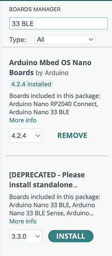

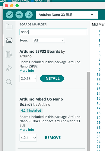

Show me what board you have selected. Here is mine. Make sure your Boards Manager looks like the 2nd pic.

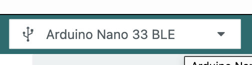

Board selected is Arduino Nano 33 BLE as per your screenshot above, here is mine:

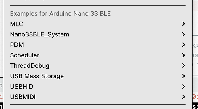

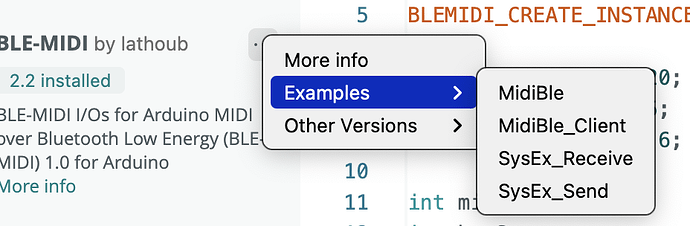

I tried one of the libraries sample sketches with the NANO and it fails. Note the reference to ESP32.
It appears there is a conflict (totally normal) between one or more of you're libraries and the board chosen.
My suggestion is to divide and conquer. If you KNOW you must use a specific board, start with the examples for that board. I just looked and there is NOT much there if anything. See attached screen shot.
IF you know the sketch you want to create NEEDS a certain library, check the samples under that library (see 2nd attached screen shot)
I have not found any combination that works other than using an esp32 board.
