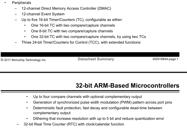

If you wanted to stay "Arduino ish" you could use a board with the SAMD21 32 bit processor. Its clock is 48Mhz and it has configurable timers that can be configure as a 32 bit counter. The program simply needs to count the overflow events and when display is required combine the overflow + current counter reading for the number of counts.
Perhaps this board from Seeed.
Of course, a comparator based front end will still be required. Perhaps the comparators on the SAMD21 can be used, I've not needed them so I can't attest to their capabilities.
The SAMD21 works with the Arduino IDE so except for a more complex setup, the SAMD21 acts like an Arduino on steroids.
