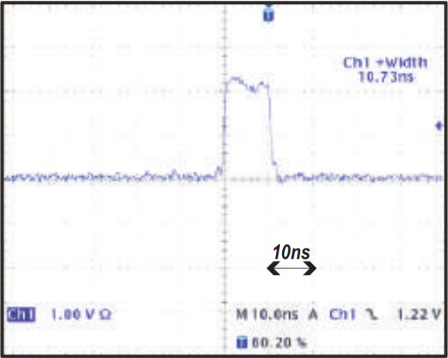

So to point of the experiment is to detect photons for a single photon detection module (id100-SMF20) that sends a pulse when it detects a photon, and the pulse looks like this:
Is there a way to count the pulses? Keep in mind the pulse are only 10ns long and the frequency of the pulse can range from 10Hz to around 500,000 Hz.

An amplified signal triggering a digital interrupt increasing a counter would do quite a lot better. If it catches a 10 nS pulse...
Yeah i think this is the problem I will run into. The 10ns pulse is too small. I used a pulse counter function and it misses almost all the pulses
You're not going to be using analogRead, so the arithmetic is irrelevant.
Read the specs for the controller, how long pulse it needs, and.... 2 volt is not high enough.
Yeah I just realized that the analogRead won't be good enough. But the question I have is will a Arduino Uno or even Due will be fast enough to detect 10ns pulses?

I don't need it to go upto 100MHz. If it even goes upto 10kHz it should be enough. What's more important is that the pulse is not more than 10ns
That's the 100MHz bit.
Ahh I see. I think the pulse is too small and might not be possible with the uno or the due. The experiment was supposed to replace a $10,000 machine. Might not be possible to replace it with a $70 machine.
Stick with it - I really don't remember much about the analogue comparator performance of the uno, and I don't even know if the Due has got one, much less its performance.
You may be able to configure a rising edge interrupt to catch it, though probably not on the Uno with only a 2V amplitude.

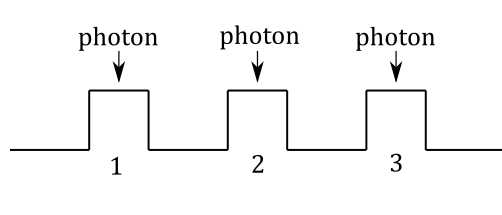

Maybe or maybe not. Just as an idea. For example, if the output of the detection module (id100-SMF20) is connected to a fast comparator (similar to LTC6752, 280 MHz), the signal at its output is extended and then the signal from the comparator is fed to the input of two binary counters (74HC4020 or 74HC4040 for example, 20 MHz) connected in cascade. Then the Arduino Nano resets the counters, starts the count, waits a second or as long as necessary, stops the count and reads the outputs of the counters. So Arduino Nano will know how many impulses there were for the time.
