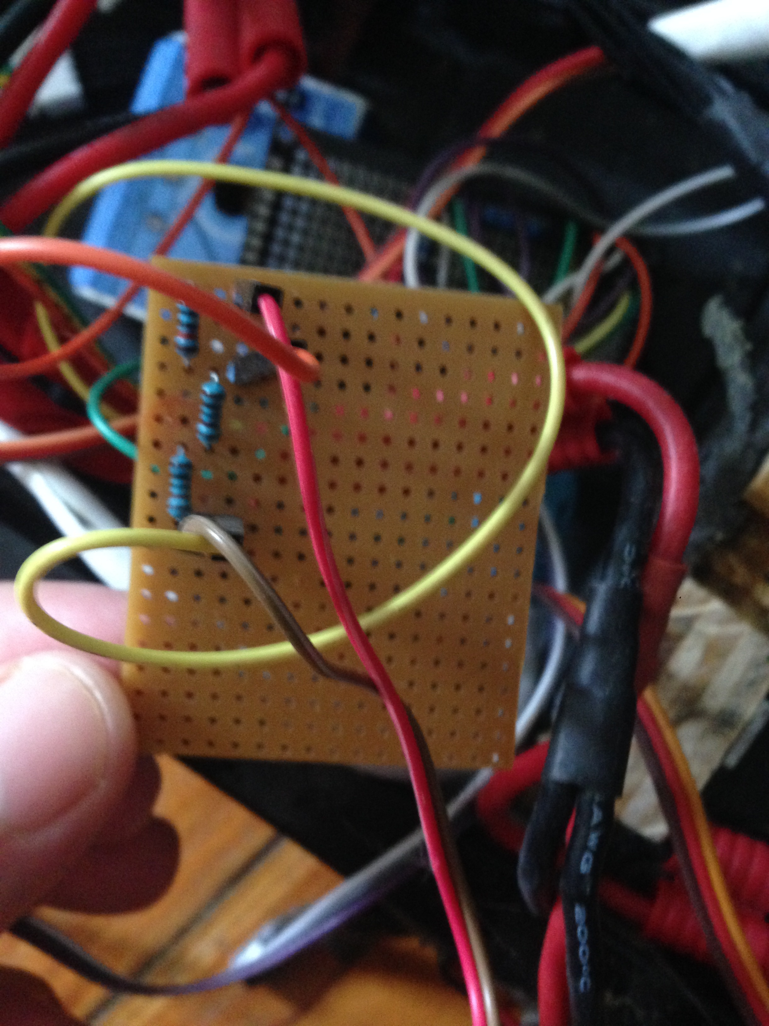

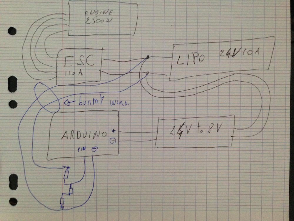

I use an arduino to send through bluetooth voltage (% batt), speed and battery temperature of my homemade electric scooter to my iPhone. The thing is that the wire of the voltmeter setup burn as well as the HM-10 BLE module when I push the throttle too hard. I think it's a current load issue but I can't figure out what's wrong. I guess it's because the arduino is powered by the same battery I want to get the voltage but I'm too noob to figure out. Here is the schematics (well sort of...).
Many thanks
Difficult to see any burnt wire in that photo ?
Whats missing from the diagram is the values of those three resistors .
Also, have you measured the maximum voltage produced at maximum engine revs ?
I've got to guess it's not wired the way you think it's wired... It should be impossible to burn-up the wires without burning-up the resistors first.
What's the value (Ohms) of those resistors?
Does the Arduino still work? i.e. Does the Blink LED sketch load & run?
That doesn't make sense either... If anything happens to the battery voltage at full-throttle, the voltage should drop. And, the current through the motor doesn't pass through those wires. The wires to the motor might burn-up, but not the wires to the Arduino.
You may have used the wrong resistor values for the voltage divider. You might have calculated the wrong ratio (giving you a much higher output than 5V max), AND/OR you have the correct ratio, but the wrong order of magnitude for each. The latter would give a correct output voltage, but would dissipate WAY TOO much power through the resistors, thus burning them (and the wire) out.

R1 = 11.96k
R2 = 2 x 1K
got the voltage through (5.04*analogRead(A0)/1024/(2/11.96))
voltage seems accurate...
The arduino works like a charm
Voltage drop a little bit when I accelerate but I guess it's normal.
That should be 2 / 13.96, Vout = Vin * R2 / (R1 + R2).
True ! Sorry R1 = 10K so R1 +R2 = 12K ~ 11.96K
I guess I put 11.96 because I measured the all thing around this value.
I did this a long time ago I'm a little bit confused.
If you're getting burnt wires it implies there's a short somewhere...
check your wiring carefully..

Got it, indeed it's a short. I feel quite stupid.
Thanks for all guys !
