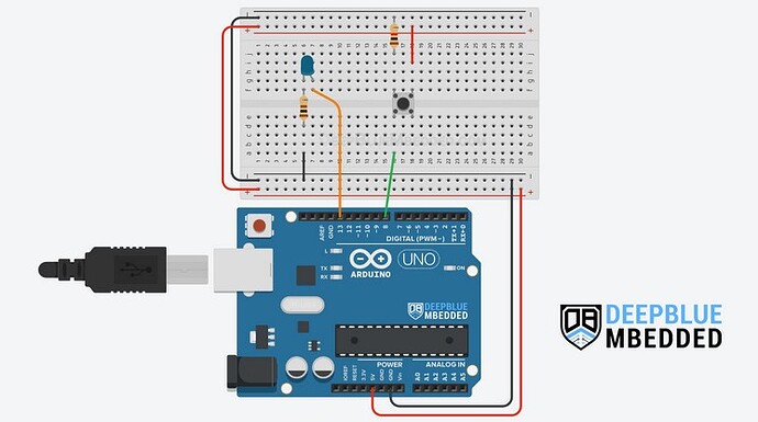

The sketch below debounces a button and uses software interrupts. My question is about the bool debounce(void) function itself. Could somebody explain what it does?? Thanks. AA
#define LED_PIN  13
#define BTN_PIN  8
#define INT0_PIN 2
unsigned long T1 = 0, T2 = 0;
void INT0_ISR(void) {
  digitalWrite(LED_PIN, !digitalRead(LED_PIN));
  pinMode(LED_PIN, OUTPUT);
  pinMode(BTN_PIN, INPUT);
  pinMode(INT0_PIN, OUTPUT);
  attachInterrupt(digitalPinToInterrupt(INT0_PIN), INT0_ISR, RISING);
  T2 = millis();
  if( (T2-T1) >= 5 )   {
    if (debounce()) {
      digitalWrite(INT0_PIN, LOW);
      delay(1);
      digitalWrite(INT0_PIN, HIGH);
    T1 = millis();
bool debounce(void) {
  static uint16_t btnState = 0;
  btnState = (btnState<<1) | (!digitalRead(BTN_PIN));
  return (btnState == 0xFFF0);
Here is the wiring.
